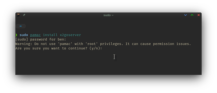

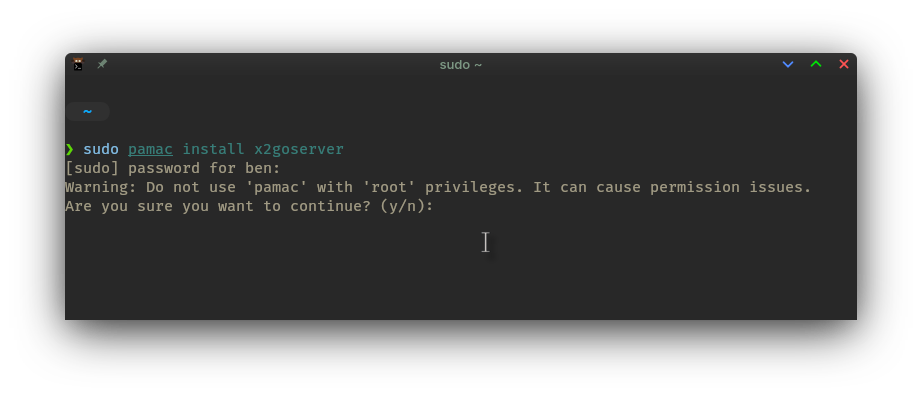

So, in the interests of a solution I would propose a quick guide for the OP right here:
Perhaps interesting for @TeaM for a built-in noob protection.
sudo touch /usr/local/bin/pamac
sudo chmod +x /usr/local/bin/pamac
sudo nano /usr/local/bin/pamac
#!/bin/bash
if [[ $(ps -o comm= $PPID) == "sudo" ]]; then
    echo "Warning: Do not use 'pamac' with 'root' privileges. It can cause permission issues."
    read -p "Are you sure you want to continue? (y/n): " choice
    if [[ $choice != "y" ]]; then
        echo "Exiting..."
        exit 1
    else
        echo "Continuing..."
    fi
fi
/usr/bin/pamac "$@"
  • Edited; now requests confirmation instead of exiting.
So have at it:
sudo pamac install x2goserver

Ok, thought about this today after another sudo pamac and changed it to warn, and ask for (y) confirmation.
