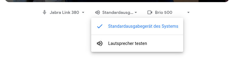

Google Meet shows standard audio output only
I’m running Manjaro with Plasma on my Lenovo ThinkBook.
#inxi -Fxz
  Kernel: 6.12.34-1-MANJARO arch: x86_64 bits: 64 compiler: gcc v: 15.1.1
  Desktop: KDE Plasma v: 6.3.5 Distro: Manjaro base: Arch Linux
I’ve attached a Logitech Brio 500 and Jabra Evolve2 75 to my USB-C dock. When trying to start a video conference with Google Meet, I can select only standard audio output for sound:
Testing my hardware with Jitsi Meet or Zoom there isn’t any problem and I’m able to select every output device explicitly. I’m using Firefox as browser. Is this a known “bug” in Google Meet or what’s the problem here?
It might be a limitation of the software, but that’s only a guess.

Pretty much, a limitation or an incompatibility in Google Meets itself. The same occurs in Google Chrome.
I wonder if the desktop client will be a bit more flexible?:
pamac search -a google-meet
silo-google-meet  0.1-1                                                      AUR
    Standalone silo app for Google Meet
google-meet-nativefier  1.0.0-2                                              AUR
    Google Meet desktop built with nativefier (electron)
The second one I guess should be sufficient. Don’t know what the first one would be for.
This is of course if you are confident using AUR packages.
If so, then issue pamac build google-meet-nativefier :slight_smile:

Thanks, but I try to avoid AUR.
# pactl list sinks short; echo; pactl get-default-sink
74      alsa_output.pci-0000_05_00.6.analog-stereo      PipeWire        s32le 2ch 48000Hz       SUSPENDED
165     alsa_output.pci-0000_05_00.1.hdmi-stereo-extra1 PipeWire        s32le 2ch 48000Hz       SUSPENDED
178     alsa_output.usb-0b0e_Jabra_Link_380_50C275B78627-00.analog-stereo       PipeWire        s16le 2ch 48000Hz       SUSPENDED
#pactl list sources short; echo; pactl get-default-source
74      alsa_output.pci-0000_05_00.6.analog-stereo.monitor      PipeWire        s32le 2ch 48000Hz       SUSPENDED
75      alsa_input.pci-0000_05_00.6.analog-stereo       PipeWire        s32le 2ch 48000Hz       SUSPENDED
165     alsa_output.pci-0000_05_00.1.hdmi-stereo-extra1.monitor PipeWire        s32le 2ch 48000Hz       SUSPENDED
177     alsa_input.usb-046d_Brio_500_2313LZ50KHW8-02.analog-stereo      PipeWire        s16le 2ch 48000Hz       SUSPENDED
178     alsa_output.usb-0b0e_Jabra_Link_380_50C275B78627-00.analog-stereo.monitor       PipeWire        s16le 2ch 48000Hz       SUSPENDED
179     alsa_input.usb-0b0e_Jabra_Link_380_50C275B78627-00.mono-fallback        PipeWire        s16le 1ch 16000Hz       SUSPENDED
