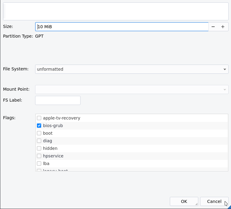

I see but look, below is what i did within Calamares:
Then, at the bottom of the last screenshot, where should i install the bootloader ? In the system partition ? I do not have any GPT option.
I don’t know why you expect a GPT option - GPT is the partition table structure - just continue with the default for the loader - it is what the unformatted partition is used for.

I do not know either to be honest, just because i have choosen the GPT partition table (on the first screenshot) and not MBR, i thought i would see it on the last screenshot to install the bootloader on.
Seeing MBR instead is confusing to me.
