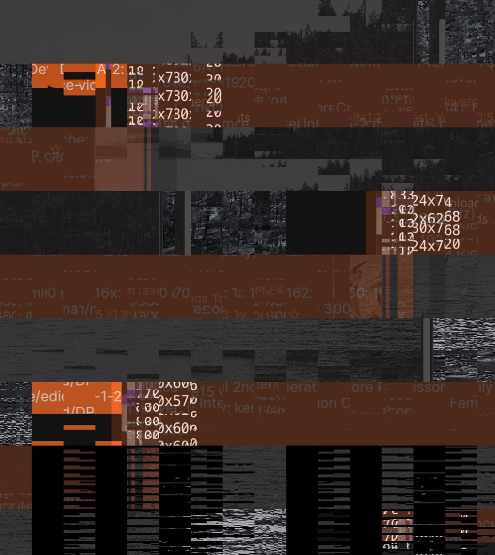

My totally uneducated guess is that the jittery/stuttery/screen tearing has something to do with GTK. The list of apps that have it are: Signal; Chromium; Vivaldi; and Brave. All others that I tried do not. But syncthing-gtk looks like this (it’s supposed to filled with information about your device and synced folders):
And this is what signal-desktop looks like in an extreme example of what happens when using – especially scrolling in – Chromium, Vivaldi, and Brave:
