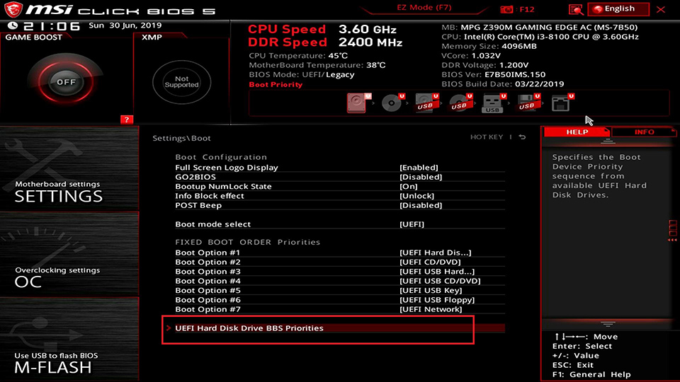

Or if your uefi (“bios” menu) supports it, manually edit the BBS priority (at least thats how it’s called on my MSI mobo) - it’s responsible for the currently installed EFI files priority, and not to be confused with boot order, cause people usually do.
Yours could be called different.
