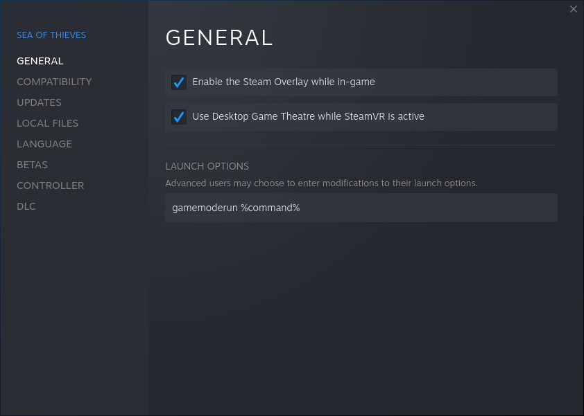

//EDIT: hu, you’re using gamemode how? you do not add gamemode TO STEAM, you add it PER GAME.
By the way, from gamemode/README.md at master · FeralInteractive/gamemode · GitHub
Or edit the Steam launch options:
gamemoderun %command%
Launch options of THE GAME :slight_smile:

I add the gamemode per game :slight_smile: But it seems that reaper_freq=5 isn’t working on my system or it may be the Gnome gamemode extensions that give false output.
