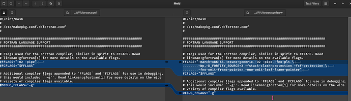

last night found two .pacnew pacman.conf and fortran.conf
I deed merge the pacman.conf but I don’t know how to hold the fortran pacnew since I don’t understand what it means…
should I overwrite it?

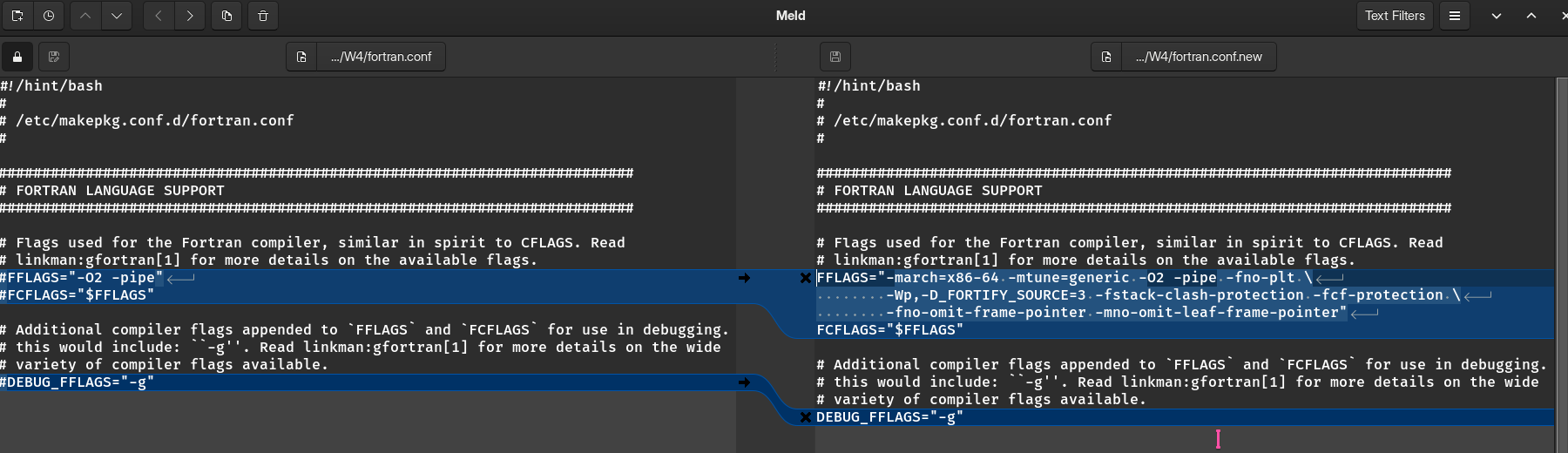

Yup, just accept it all
you don’t have anything invested there, it’s not anything custom to your personal needs - it’s just tweaking the system.

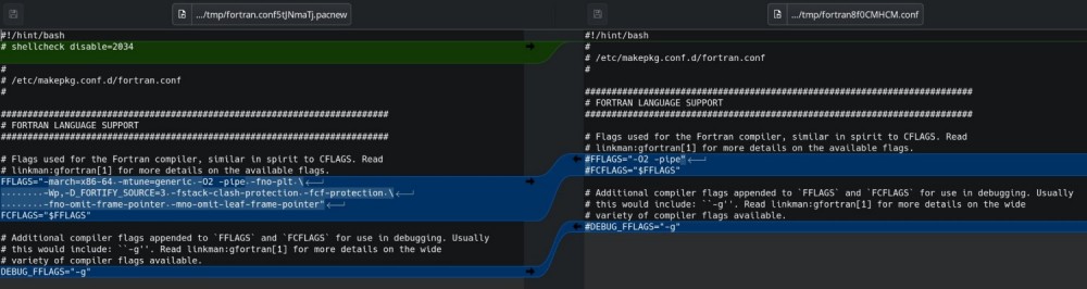

They’re opposite, because I was comparing the current one with a version I copied in from a snapshot.
The original had/has nothing in it - everything commented out.
The new one has some sane defaults in it.
In this case - just swap one for the other.
You’ll likely never see any effect whatever you do because it is rather unlikely that you’ll be compiling Fortran code.
