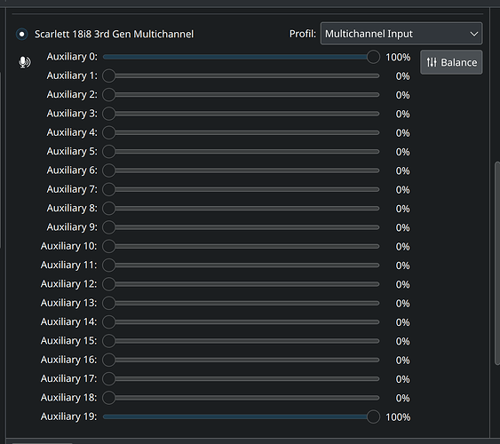

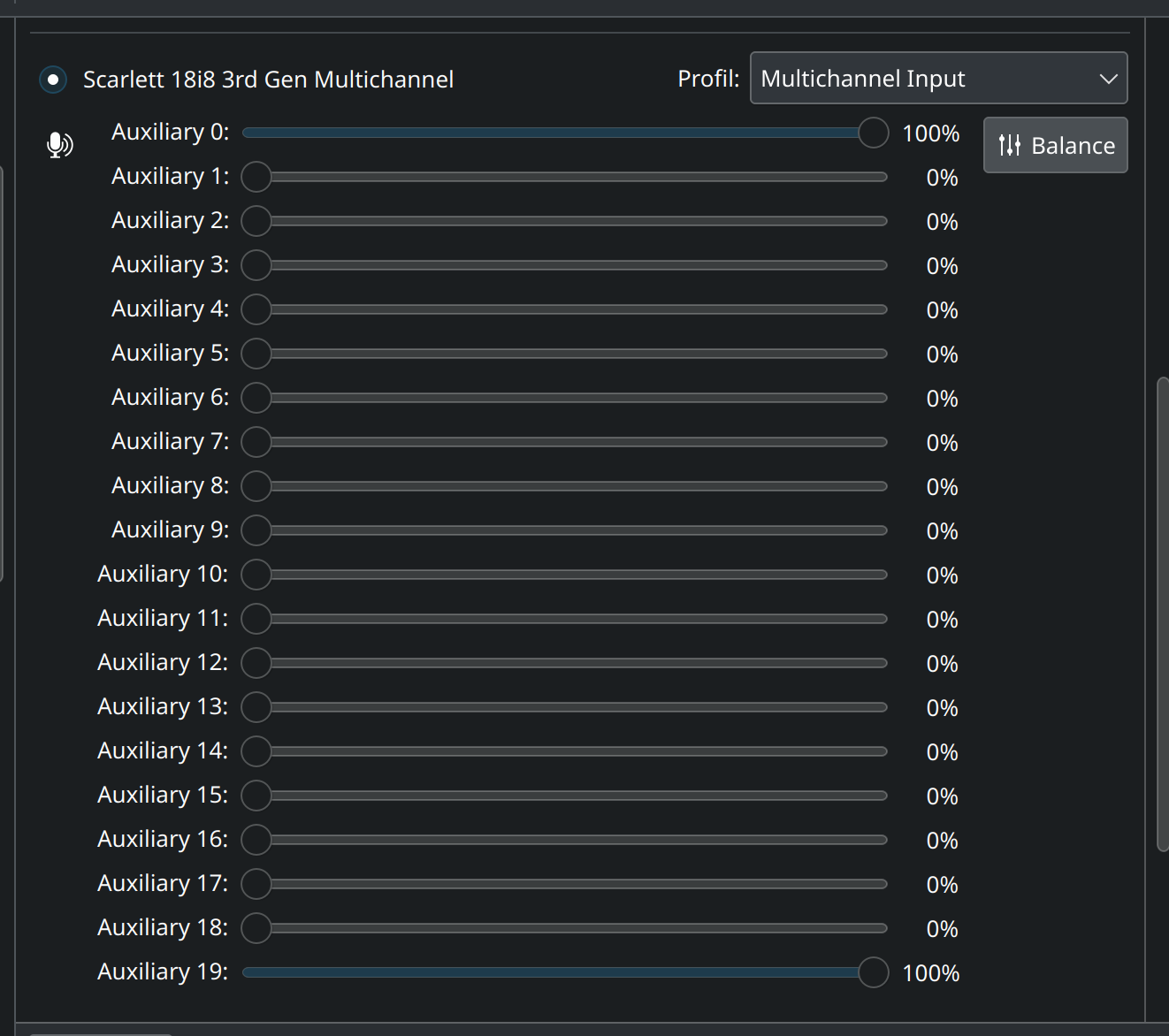

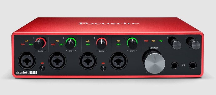

I bought a new focusrite scalett 18i8 3 gen a few days ago. I get 19 channels in the sound configuration in the kde control center and have selected multichannel input for focusrite there.
I use Vokoscreen to record my Linux movies. Basically, I use focusrite for music production. But in the previous focusrite 6i6 2nd gen I had, I also used it for my video recordings in linux.
But with the new 18i8 I have one panning problem! Regardless of the settings, I only get output sound on the left when I play the movie! Note; I don’t have this problem if I use my 4K logotech web camera’s microphone in Vokoscreen or the microphone on my headphones.
Is the focusrite scalett 18i8 3 gen not fully supported in Manjaro? Or is there something I don’t see or understand here?

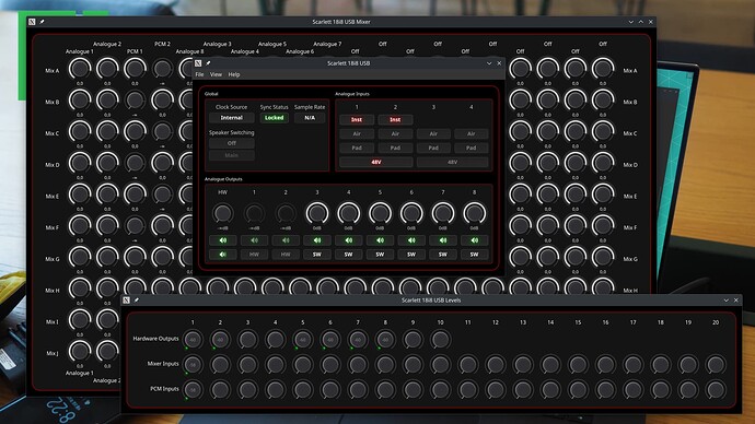

Yes I installed this software in Manjaro linux and everything seems to work, see my pictures below here.

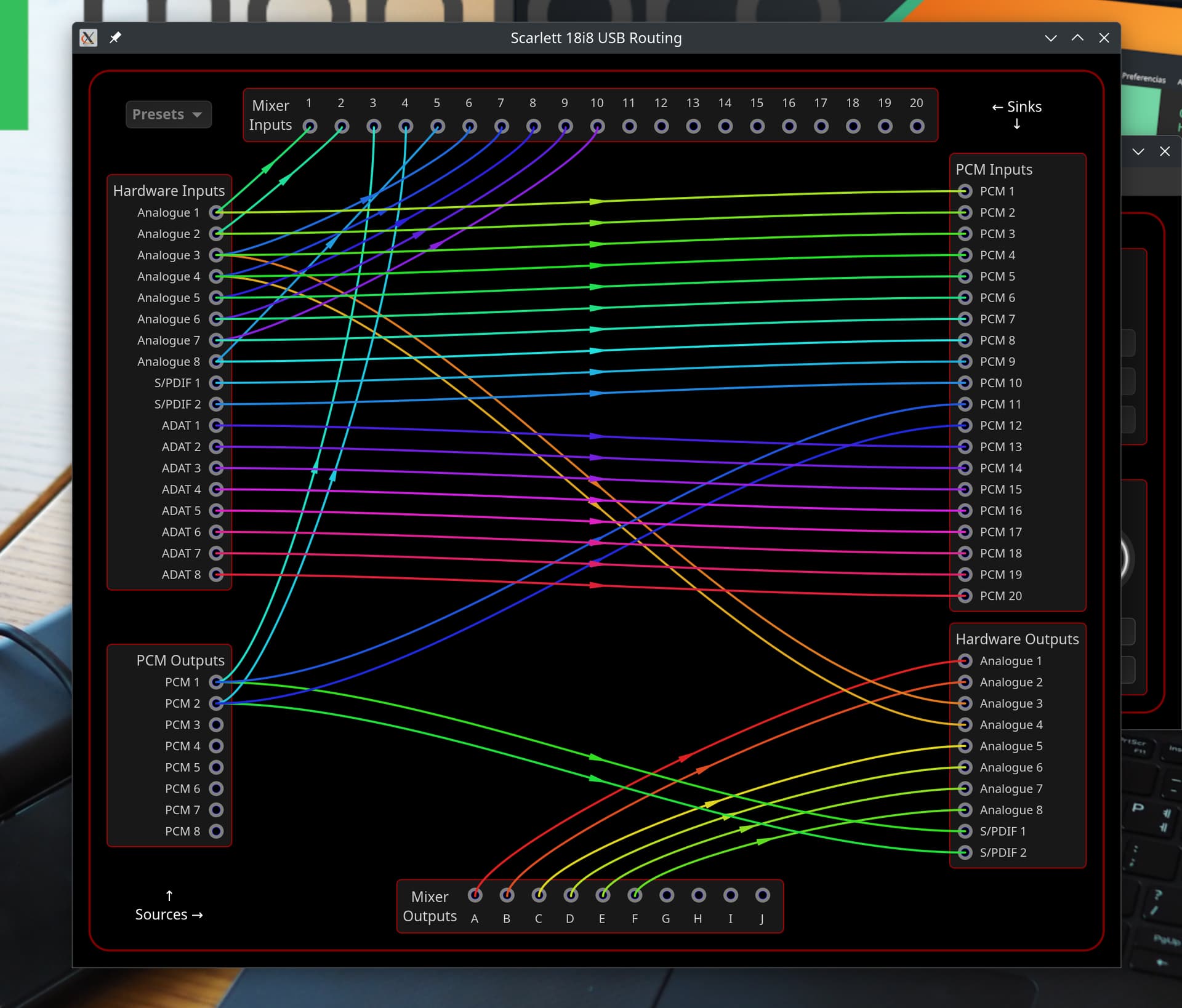

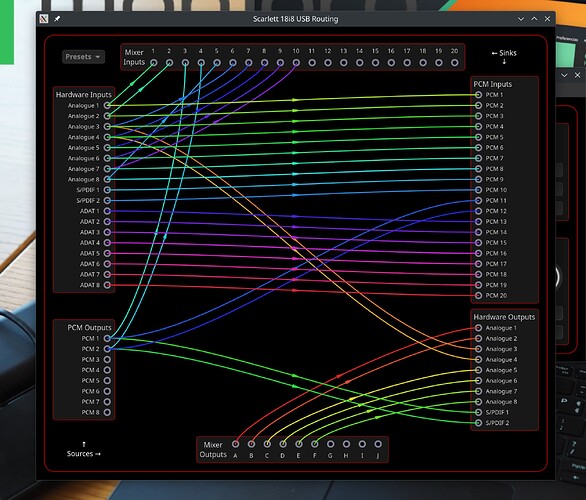

But then there was this with routing. This is what my standard looks like after I switch on focusrite. I don’t understand much of this, maybe someone can explain to me what things should be set! How do I pan the channel where the microphone is connected on the focusrite, it is connected to the first input on the forcusrite. Incidentally, I have two keyboards connected to four inputs on the back, to get stereo.
For those of you wondering how I installed alsa scarlett in Manjaro. see the instructions below here.

I tested OBS. And it went well there, because I can set the mic to mono in the advanced settings in OBS. When it comes to Mixcraft studio in Win10, I have tested it via Wine in Linux with success before. Also my Thontrack music programs. But it is quite clear that it would have been an advantage if I understood something more about Routing in Alsa-Scarlett. Too bad about Vokoscreen, which I like so much.

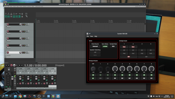

In Reaper studio on Manjaro i get this right, i have licens on Reaper.
The mic its mono there. And i hopes there are stereo also for there other channels!

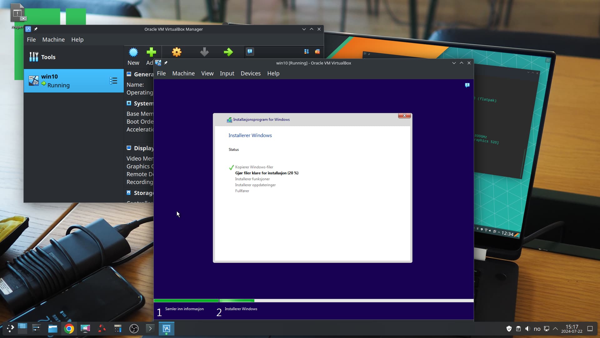

But i haven`t givit up win software in Manjaro. So now i will try install win10 on virtualbox.
But no, the virtual box on Manjaro wont working vid usb and Focusrite! so the focusrite control app have a black screen there to. So that`s it. For Music production i most continue use win10 on the physical computer, like i have did all time.

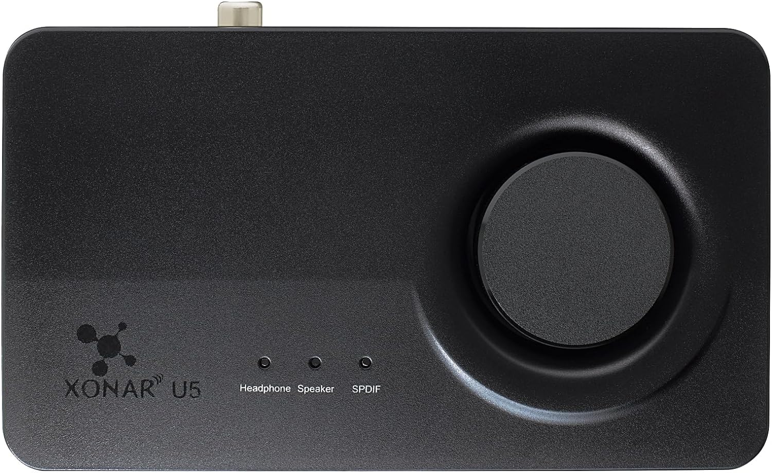

I am getting a new USB sound card for the computer this week. "Asus Xonar U5 " 5.1 so that I can get this to work better with Manjaro, instead of the sound card that I have used for a number of years “soundblaster z” which has also started to have problems in windows10. I’m not too keen on Dolby on the computer, as I never watch movies on the computer. As I understand it, this sound card “Asus Xonar U5” should be fully compatible with Linux.

And Reaper music studio works brilliantly in Manjaro with the new Focusrite sound card. But I will probably have to continue editing the music in Windows, as I have the best music production programs I depend on there.
Below you see a picture of the Reaper studio and the Alsa-Scarlett control center in Manjaro.
