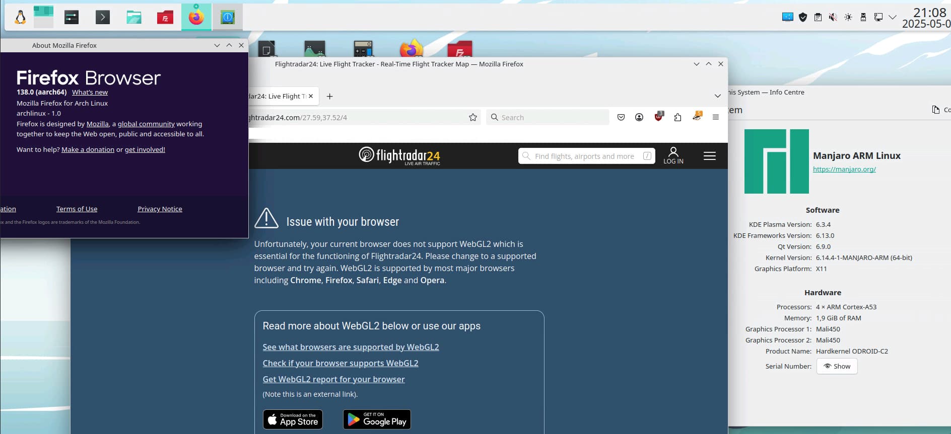

I did a test with my odroid c2 (Plasma desktop), no freezes, no crashes but some error message, see below
WebGL 2.0
The WebGL 2.0 specification has recently been released, and implementations of the new API are becoming available.
WebGL 2.0 requires hardware with OpenGL ES 3.0 support or comparable desktop OpenGL
 feature support. Not all systems capable of running WebGL 1.0 will be able to run WebGL
 2.0. See http://caniuse.com/#feat=webgl2 for availability details.
Hmm. While your browser seems to support WebGL2, it is disabled or unavailable. If
possible, please ensure that you are running the latest drivers for your video card.
For more help, please click this link.
https://support.mozilla.org/en-US/kb/upgrade-graphics-drivers-use-hardware-acceleration?redirectslug=how-do-i-upgrade-my-graphics-drivers&redirectlocale=en-US

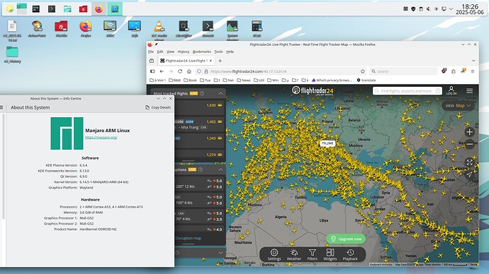

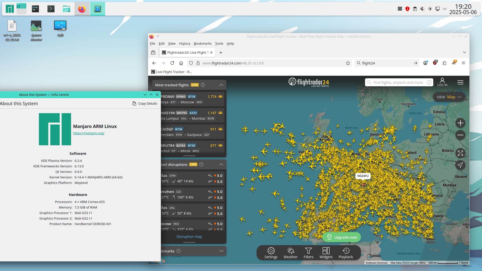

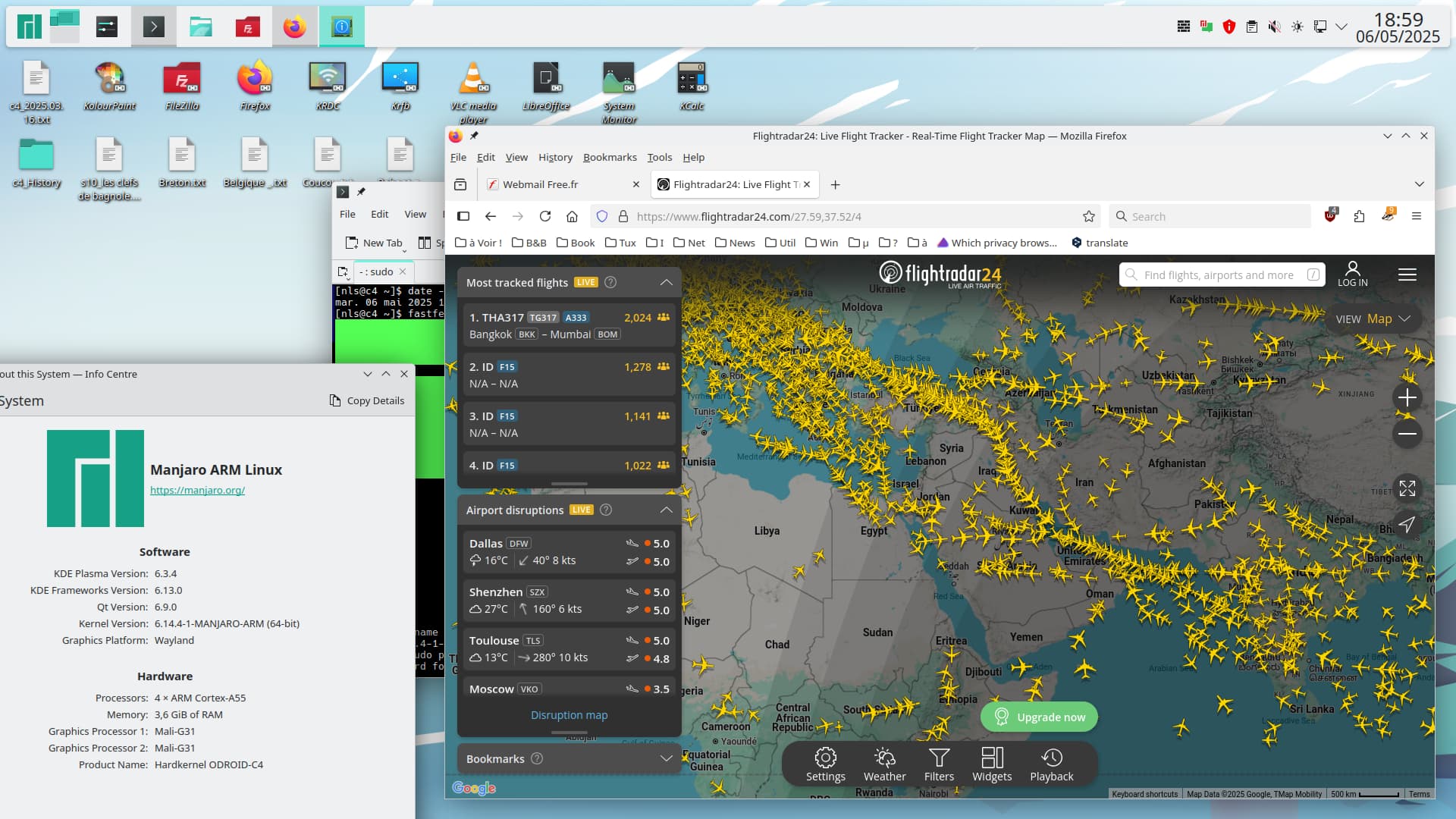

No issue with Firefox on the following devices
Odroid C4
Odroid N2
Odroid M1
Given that, it seems likely it could be a problem with the site.
