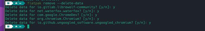

Hi all, in Konsole, if I use the command:
flatpak remove --delete-data
I always see this:
And if I run it again, I get this:
However, upon restarting my system, running the command will bring up the exact same list of software in the first screenshot.

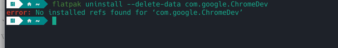

But if I try running a targeted command against one of the packages listed above, I get this error:
Is there a way to truly purge all traces of the aforementioned flatpak packages?
I don’t have this issue with other flatpak packages I’ve installed and uninstalled.

Ah, right, just to be clear, I have flatpack packages that I do use and like to continue to use; the issue is with packages that seem to have lingering associated files that “return” after a reboot.
flatpak list
Pulls up all currently active flatpak packages, and none of the ones in the first screenshot in my original post shows up. And if I were to install and then uninstall any new flatpaks, they also do not show up if I use the
command.
Update: I managed to resolve the issue by re-installing all of the packages listed in the first screenshot, then uninstalling them via:
>flatpak uninstall --delete-data (package names)
Not sure why I didn’t try this the first time.
Edit: Spoke too soon. Upon a restart, the phantoms came back.
