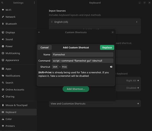

, Thanks that’s the only workaround that did actually work for me:
opened 06:03AM - 07 Oct 23 UTC
Unconfirmed Bug
### Flameshot Version
Flameshot v12.1.0 (-)
Compiled with Qt 5.15.10
##… # Installation Type
Linux, MacOS, or Windows Package manager (apt, pacman, eopkg, choco, brew, ...)
### Operating System type and version
Arch with kernel 6.5.4-273-tkg-bore
### Description
When using a shortcut (Print screen) to run Flameshot I get "Unable to capture screen".
When I run the command from the shortcut in a terminal, it works.
Now both used to work fine before, but stopped working after my daily updates sometime this week. The normal Gnome screenshot program still works.
If you can tell me where I should look for further logs, please do, so I can upload them.
### Steps to reproduce
In Arch running Gnome:
1. Bind screenshot a region key to printscreen and set it to `/usr/bin/flameshot gui`
2. Use key to trigger flameshot
3. Get Unable to capture screen error
### Screenshots or screen recordings
(Shortcut settings)
### System Information
Host: tuxgamer Kernel: 6.5.4-273-tkg-bore arch: x86_64 bits: 64
Desktop: GNOME v: 44.5 Distro: Arch Linux
Device-1: AMD Navi 22 [Radeon RX 6700/6700 XT/6750 XT / 6800M/6850M XT]
driver: amdgpu v: kernel
Device-2: Logitech Brio 500 driver: hid-generic,usbhid,uvcvideo type: USB
Device-3: Chicony USB2.0 FHD UVC WebCam driver: uvcvideo type: USB
Display: wayland server: X.org v: 1.21.1.8 with: Xwayland v: 23.2.1
compositor: gnome-shell driver: X: loaded: modesetting dri: radeonsi
gpu: amdgpu resolution: 5120x1440~60Hz
API: EGL v: 1.5 drivers: kms_swrast,radeonsi,swrast
API: OpenGL v: 4.6 compat-v: 4.5 vendor: amd mesa v: 23.2.1-arch1.2
renderer: AMD Radeon RX 6700 XT (navi22 LLVM 16.0.6 DRM 3.54
6.5.4-273-tkg-bore)
Settings
Keyboard
View and Customize Shortcuts
Custom Shortcuts
Add Custom Shortcut:
a. Name: Flameshot (or whatever you want)
b. shift + Print Screen Keys (or whatever you want)
c. Command: script --command "flameshot gui" /dev/null
And voila, you’re all set!
Thank you for the solution! It worked for me too.
