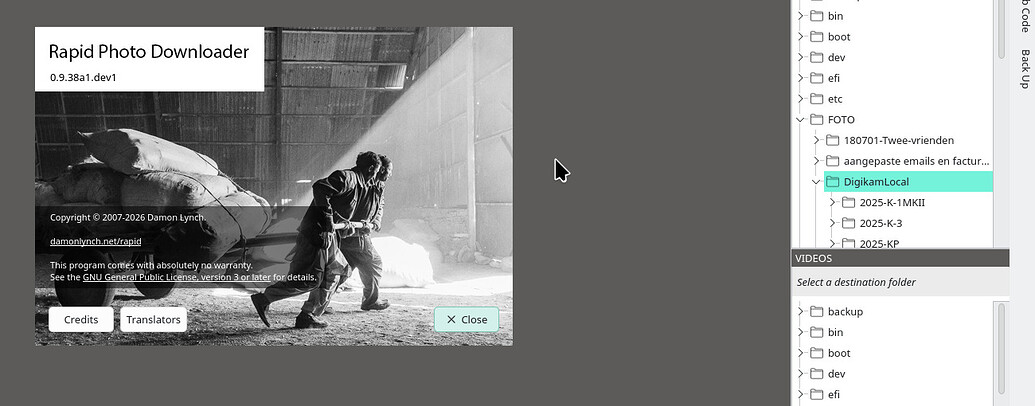

Fully aware of that, yes. I have now patched my install to 9.38a1.dev1 as you can see on the screenprint above and it runs perfectly fine this way.
