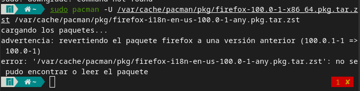

Sorry, not working for me that option, look :confused:
Not working here :confused:

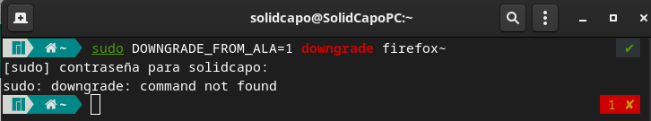

Same issue here, but find an easier solution on the Manjaro site:
pamac install downgrade
worked for me… :smiley:
