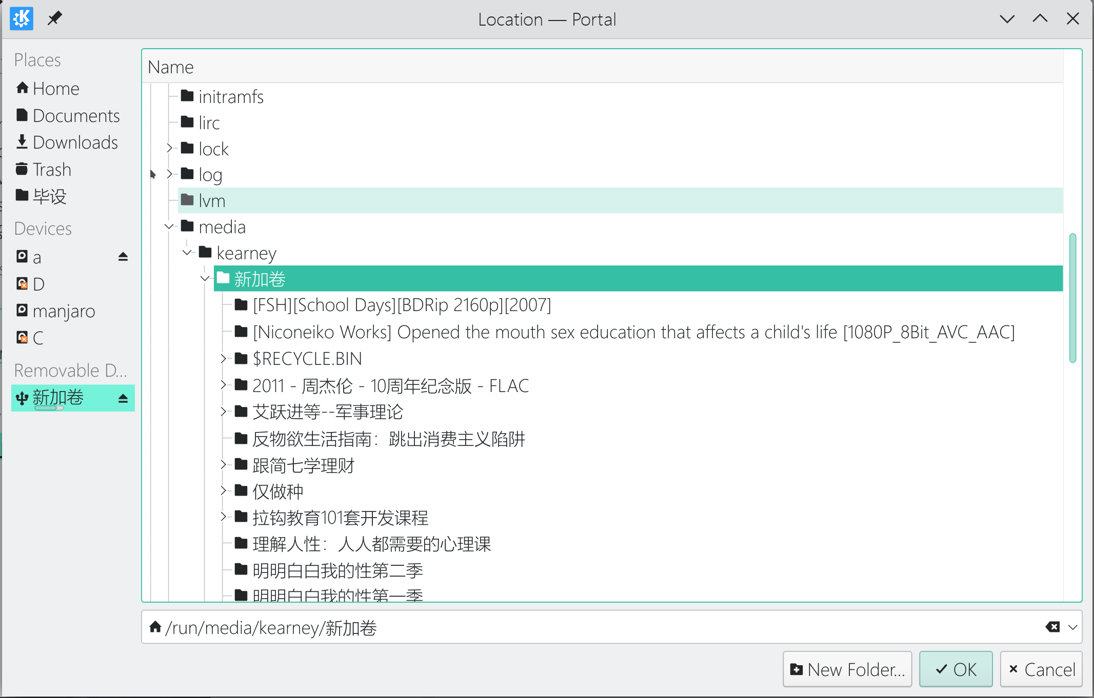

I use USB-SATA cable to connect my HDD for a long time. There days the firefox get some problem after I use qBitorrent delete some file on HDD.
When I choose file or floder in my HDD named 新加卷 from firefox, it will got this info:
I have change my display language into English and my firefox language still is English(US). Reboot to make sure language. It still display Chinese. The info means:
“Unable to read the content of HDD(新加卷). Get file “/run/media/kearney/新加卷/男士穿搭指南:用穿搭。。加分” info error: Input/Output Error”
The file named “男士穿搭指南:用穿搭。。加分” was deleted last night via qBitorrent.
I think it file choose dialog problem. But I try same thing with chromium. It is ok without any wrong info.
This Change Firefox file manager - #3 by Aragorn tells about kdialog. I try kdialog --getexistingdirectory. It show a dialog like that in chromium. So I do not know what is wrong with the firefox?
Anothoer wired thing is chrominum got all floders in that HDD while firefoe only got 6 floders.

Possible… how is the drive mounted?
Normally I mount it like this:
LABEL=data   /media/data   ntfs-3g      defaults,noatime,noauto,windows_names,hide_hid_files,hide_dot_files,big_writes,uid=1000,gid=1000 0 0
Could be a problem with windows_names?
I use Dolphin(File manager) in Plasma. Just clike the icon the mount :smiley:
I am puzzling what it could be…
I would say it is clearly related to the Chinese (?) Symbols and NTFS.
I tried to reproduce it on my ntfs partition:
mkdir "男士穿搭指南:用穿搭。。加分"
and choose it with firefox (which is german). Everything works as expected.
maybe read this:
       windows_names
              This option prevents files, directories and extended attributes to be created with a name not allowed
              by windows, because
                     - it contains some not allowed character,
                     - or the last character is a space or a dot,
                     - or the name is reserved.
              The forbidden characters are the nine characters " * / : < > ? \ | and those whose code is less  than
              0x20,  and  the reserved names are CON, PRN, AUX, NUL, COM1..COM9, LPT1..LPT9, with no suffix or fol‐
              lowed by a dot.
              Existing such files can still be read (and renamed).
man ntfs-3g
yes. Not the Chinese encod problem. I use the HDD a long time. This error info just happen after I delete the folder and its files in qBittorrent. But the error info not happen in Chrominum or kdialog. So I think the firefox choose folder not use kdialog. Though firefox and Chrominum both use gtk3 as depends.
I think remove firefox totally(cache, config and so on) will work. Before I do that thing I think I should check what happen.
Chromium uses KDialog when used on a KDE environment.
agree. test above
I run disk check without repair on Windows 11. It says that there is no error with the HDD. Then I return to firefox. The problem disappear. So there are two possiblility
  1. HDD does exist some problem and the check process think it’s not a big deal not repair it without info.
  2. HDD’s fine. Firefox refresh cache for some reason.
