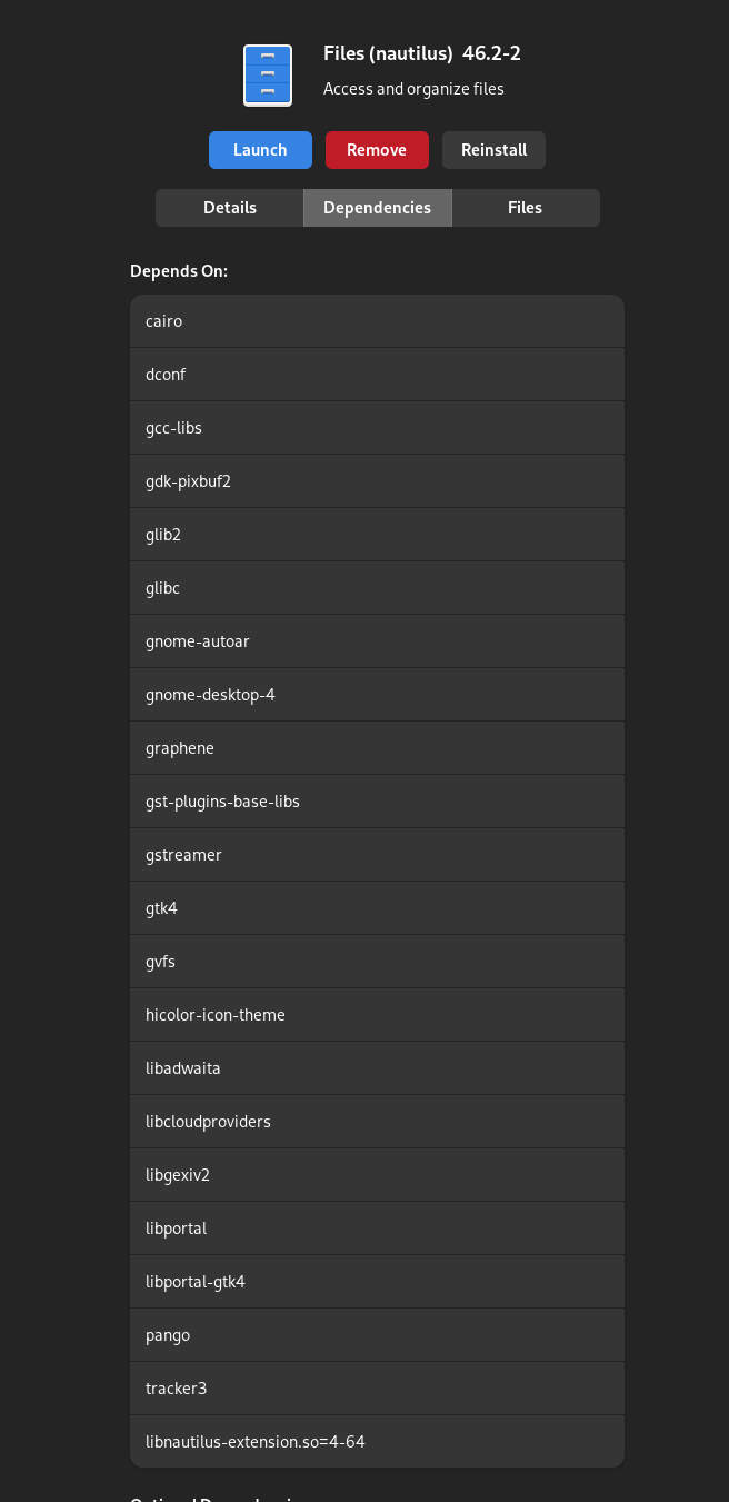

Clicking on the files app does not open. Dialog boxes from web browser which use file browsing are working. Running in terminal gives the following:
** Message: 16:44:32.159: Connecting to org.freedesktop.Tracker3.Miner.Files
Namespace Nautilus is already loaded with version 4.0
This happened a long time ago when i accidently uninstalled electron - but it is there now.
Reinstalling, launching through pacman does not work either. What am i missing?
