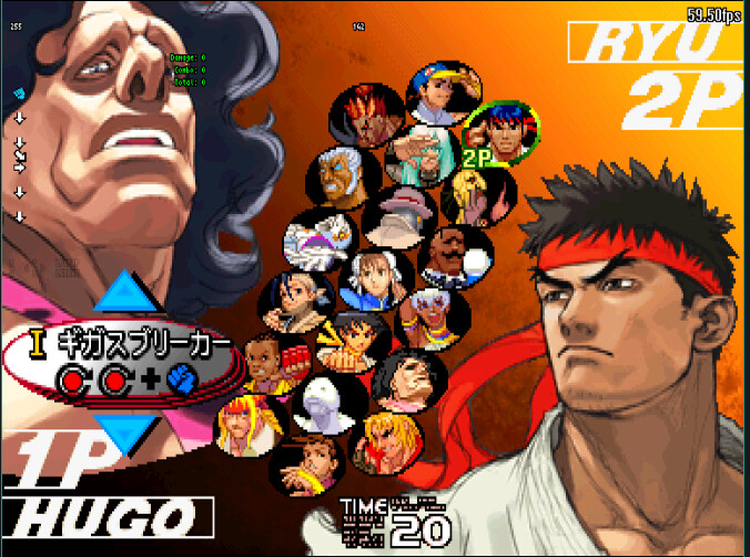

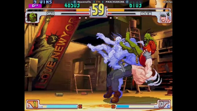

Managed to install fightcade2 through the AUR, but the overlay while in game is not showing up, even thought he option is active.
With overlay I mean in-game chat, training mode hitboxes and such.
Here’s an example image:
On the upper part of the screen there’s the player ID and the frame rate, there are more options to show, but that’s just an example

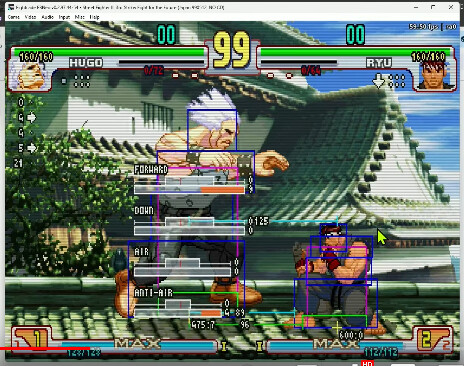

Training mode has a lot of options for overlays and information, but nothing show up either, heres an example of how traning mode should look like:
Any ideas?
