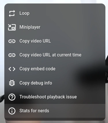

First, is hardware acceleration enabled or disabled in falkon’s settings? You can check by opening Falkon’s preferences via the hamburger menu or with the shortcut Ctrl+Shift+,.
Go to the Browsing → Web Configuration section, change the hardware acceleration setting, restart falkon & see if that makes any difference.

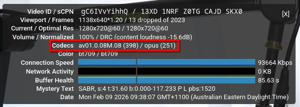

You could also check if the issue is occurring with certain video formats/codecs. When a YouTube video is playing, right-click on it & select “Stats for Nerds” at the bottom of the list:
That will then present you with an overlay where you can see which video format/codec is being used:
See if the issue occurs across multiple formats (eg av01, avc, vp9), or if it is limited to just one type of video.

I will admit that I’m not an expert on video codecs, but I currently have a YouTube video open in falkon, and it’s playing without any problems. Check if you can play this… :backhand_index_pointing_down:
(Yes, I’m probably showing my age here — this came out when I was 14. :grin:)
Mod edit:- Malformed URL corrected. No charge. The invoice in the mail.
I could not open the link you sent, but a similar one is
This works without problem, and I can rightclick the video to get additional information.
Then it would indeed appear to be a codec issue. :face_with_raised_eyebrow:
