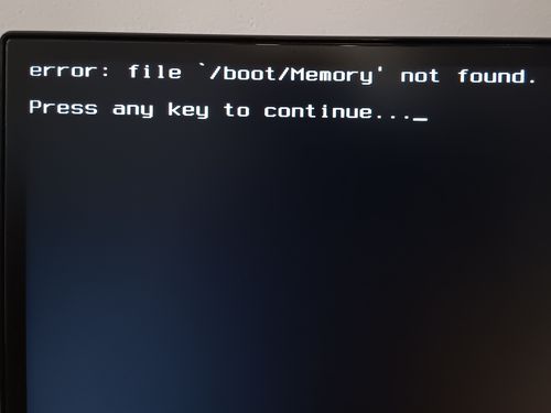

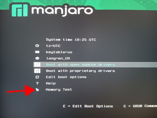

I added 8GB to my computer. Booted with a Manjaro KDE 24 ISO, chose ‘Memory Test’ to check the new memory module and there is no test, there is an “error: file ‘/boot/Memory’ not found” message. Inside the /boot directory there is no file called “Memory” but there is one “Memtest”. I suppose there will be somewhere a typo with the file name.
Presumably in your config. The file is /boot/memtest86+/memtest.bin, but presumably you know that, just in case anyone gets confused.
I’m updating now to see if I can replicate (but not on plasma).
I boot with a Live ISO, no config here.
Download KDE 24 ISO, write to a usb drive, boot with it, select “Memory Test” and the error appears. This is the content of the boot folder in usb drive. No “memtest86+” folder.

-r--r--r-- 1 jc jc    147744 jun 11 05:41 memtest
-r--r--r-- 1 jc jc  13283840 jun 11 05:40 vmlinuz-x86_64

To make things easier, if you boot with a Live KDE ISO and select this:
1
You only get that:
2
