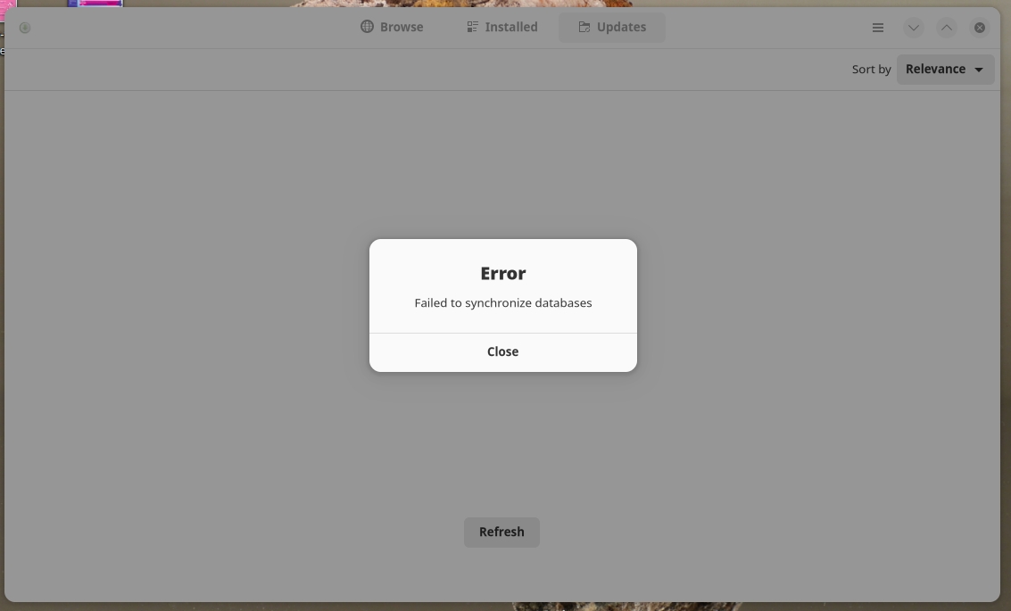

That took a few hours to run. It did complete but there were a few errors and warnings showing when I scrolled back up through the CL. Now, when i attempt to update using the GUI I get the error message in this screen grab…
Then use the terminal:
sudo pacman-mirrors --geoip
sudo rm -rf /var/tmp/pamac
sudo pacman -Syyu
Please don’t post screenshots of this very simple error message. Just post it.
Sorry about the big screenshot for very little content. I guess it wastes a lot of bandwidth and wasn’t thinking.
