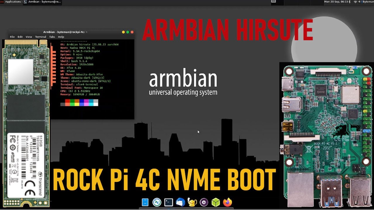

Up until today I had only tried the pcie-gen2 overlay on Radxa Ubuntu but today I verified that it works under Armbian too.
To activate it under Armbian, you need to edit /boot/armbianEnv.txt and add the line:
overlays=pcie-gen2
Then reboot. Without this line, I get ~200 MB/s read speeds off my Samsung EVO 960. With the pci-gen2 overlay enabled I get ~360 MB/s which is definitely a notable and worthwhile improvement.
