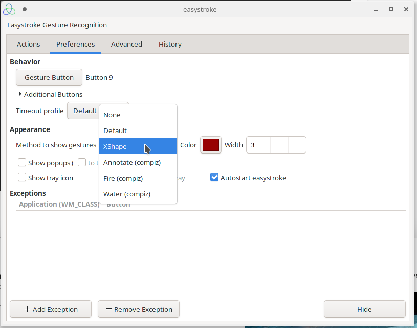

After installing the last update via pamac, the easystroke gesture drawer started to create black squares on the desktop. How do I fix this?
UPD:
I solved the problem by changing the easystroke method of show gesture to XShape. But I wonder why the default is broken?

Switching to Xshape solve for a time, but after some time (or using other software probably), the black squares come back, as if easystroke reset in default mode (but xshape is selected). Select Default, and select back xshape fix again.
