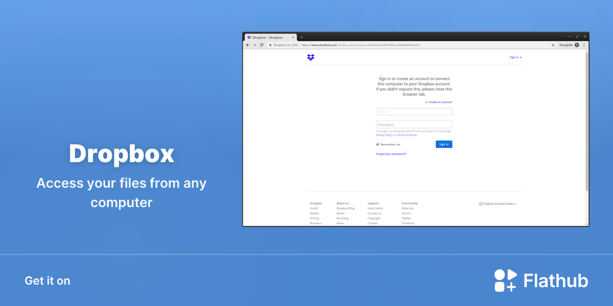

One small practical difference is the permissions you actually grant. The Flatpak still needs network access and usually broad access to the Dropbox folder, so I would not treat the sandbox as magic containment. I’d check the Flathub maintainer/source, then look at the permissions with Flatseal or flatpak info --show-permissions com.dropbox.Client and keep the synced folder as narrow as possible.

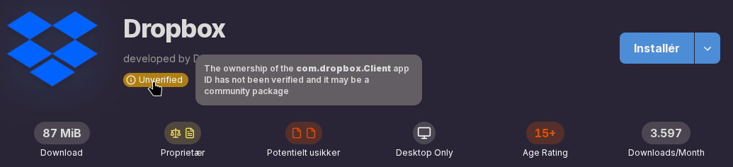

Adding to this, the “verified”/“unverified” designation on Flathub seems to be whether or not the package maintainer is the developer of the package. It sounds as though both verified and unverified packages receive the same safety checks on Flathub (although an unverified maintainer would not suffer the same reputational damage for a compromised package as a verified one).
