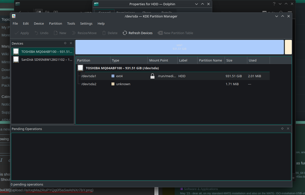

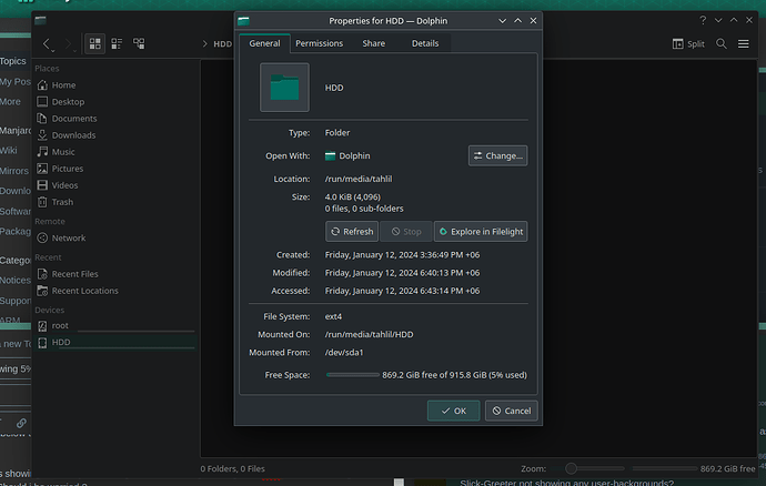

So dolphin is showing 5% of my disk being filled even though through the KDE Partition Manager it is shown not. Should i be worried ?

That is fine, AFAIK. Because the disc itself contains data about itself, metadata. That data obviously takes up space.
And so Dolphin takes it into account. Since it’s a file manager, that has to keep track of such things. Partition manager, on the other hand, manages your partitions which aren’t files.
I’m primarily scared cause 5% of 931.51 is like 46GB. Would the Hard disk information really take that much storage away ?
The first thing you should realize is that a partition is not the same thing as a filesystem. A partition commonly has a filesystem on it, but in and of itself, a partition is only a reserved section of a storage medium.
Now, once the partition has been formatted with a journaling filesystem such as ext4 or btrfs, part of the filesystem becomes reserved for (among other things) the filesystem journal and is therefore “in use”. And 5% seems about right, yes.
