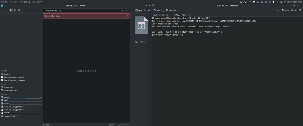

Just to confirm, you get this window:
  • Enter passphrase for: /path/to/key
And no other popup for a user or password.
If so, that tells me ksshpass is already installed. And you probably need to set one variable for it to work: $SSH_ASKPASS.
It may have hung up at that step, and never got to the next step with the password.
The blog I linked mentioned this variable, but here’s an Arch Wiki link doing the same thing:
https://wiki.archlinux.org/title/KDE_Wallet#Using_the_KDE_Wallet_to_store_ssh_key_passphrases
Just assigning at least one variable in: ~/.config/environment.d
I do not use encrypted key, so no need for a passphrase.
The steps are simple, so again:
Server requires key AND user password.
The window that does not come up is the window asking for the user password.
I tried logging what is described in:
The log shows that the key is accepted by the server and then fails which is correct because Dolphin never shows the prompt for the user password.
On the cli it works flawlessly, both ssh and sftp.
But i now tried with
fish://username@IP
in Dolphin and it works flawlessly.
So it still seems something is wrong with Dolphin, or whatever layer underneath it, that handles sftp.
