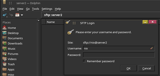

To test this I have altered my remote server setup
The server’s /etc/ssh/sshd_config configuration had this added
# Authentication:
AuthenticationMethods "publickey,password" "publickey,keyboard-interactive"
Then restart the service systemctl restart sshd
When you connect using dolphin
Create an entry in your ~/.ssh/config to use the correct ssh key (you cannot provide the key as part of the connection string in dolphin)
Host server2
  hostname some.domain.tld
  port 33333
  identityfile ~/.ssh/server2.key
  user nix
Connecting with dolphin - make sure you supply the username as part of the connection string sftp://nix@server2 - this will open a password dialog with the username preset - all you have to do is provide the password.
