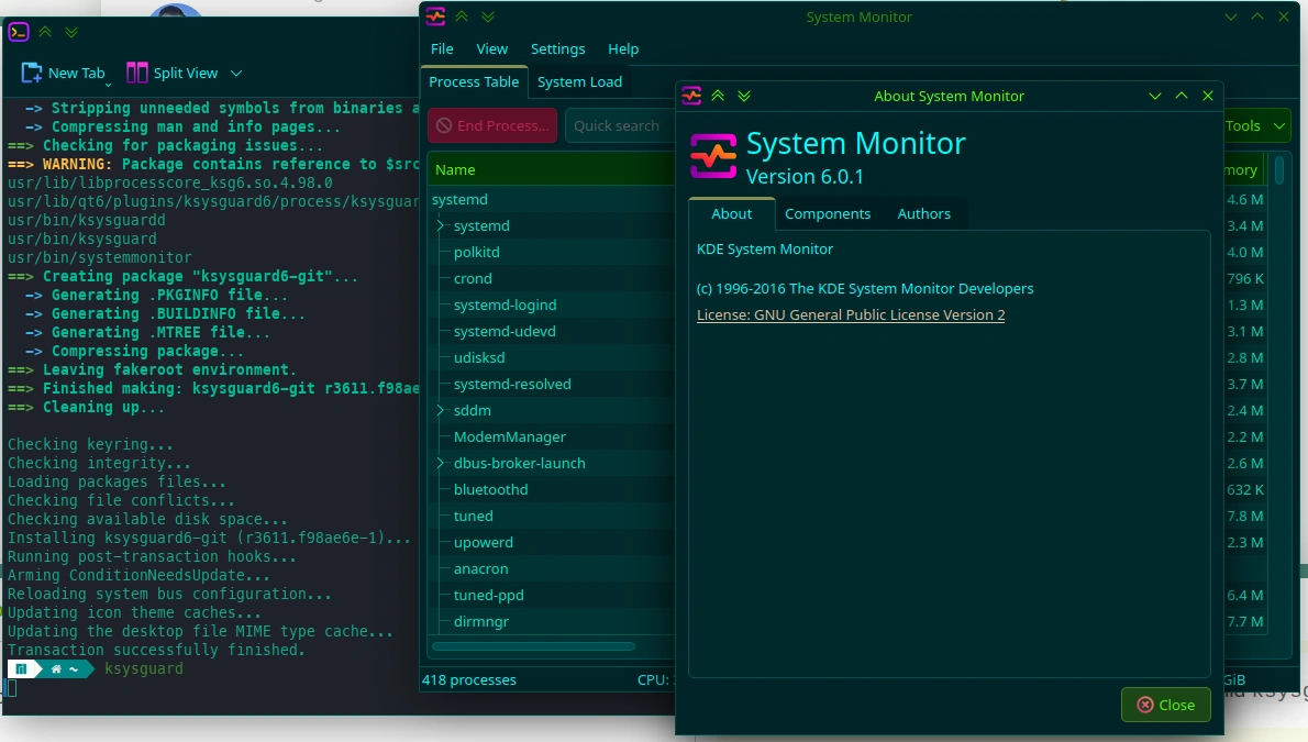

I recently removed all AUR packages to be sure no old versions stick around.
After that ksysguard6-git failed to compile and complained about the same library.

As @ben75 said:
Have you been holding back (ignoring) any packages or groups when updating? Possibly because of AUR dependency issues when updating via pamac?
Maybe it is best you refresh your mirrors & do a full system update without the AUR via the command line:
sudo pacman-mirrors --continent && sudo pacman -Syu
Once your system is up-to-date, you can then try to build ksysguard6-git again:
pamac build ksysguard6-git
I just successfully built & opened ksysguard6-git on my Testing branch system, which is on the same versions of plasma & kf6 as Stable branch:
thanks. that did it. solid was installed from AUR. Even if I recently uninstalled all AUR packages using the method from the manjaro update guidelines.
No, my system is not out of date, it was just this one library.
Going to check if there are any other AUR installs that shouln’t be there.
Edit: there were an bunch. I replaced all “-git” packages that weren’t explicit requirements by me :slight_smile:
Glad you got it all sorted out. The issue was possibly exacerbated by the fact that the solid-git AUR package requires the latest version of Frameworks to build.
Even if pamac did try to update it on your Stable system (the -git version of AUR packages should install the latest version, regardless of the version shown in the PKGBUILD), the build would most likely have failed due to your system having an older version of kf6. Which left you stuck with solid v6.3.0.
