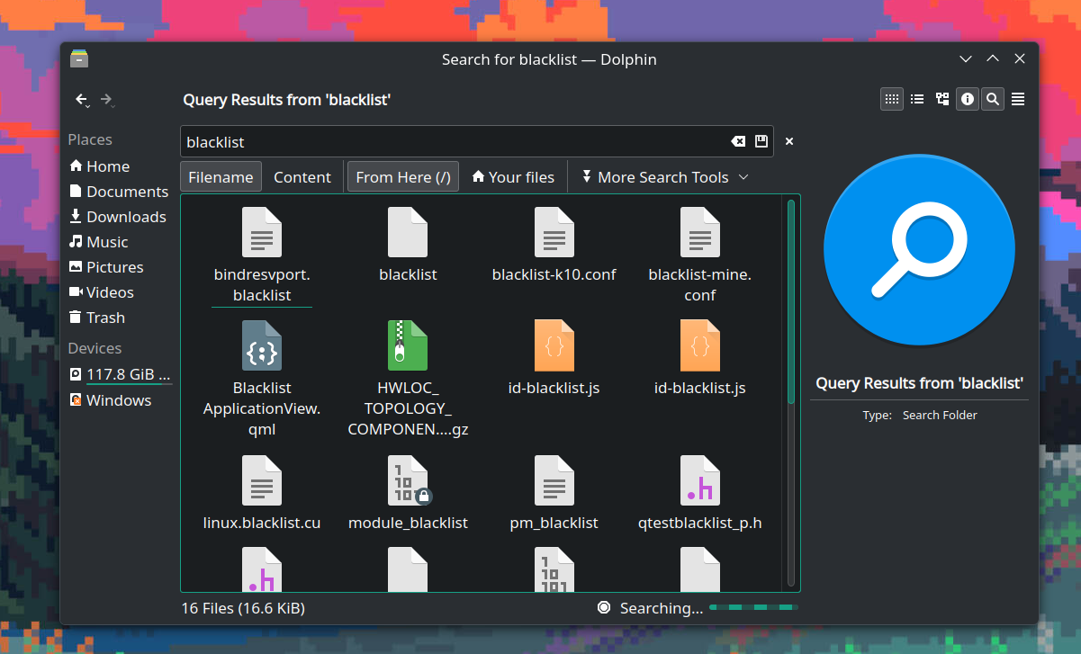

Dolphin doesn't find any file when searching "Frome here"
Topic pretty much says it all. I can’t seem to find any file when searching “From here” even if i type the exact filename of a file i’ll get “No matching element for search”. ANyone has a cloe what could be the reason?

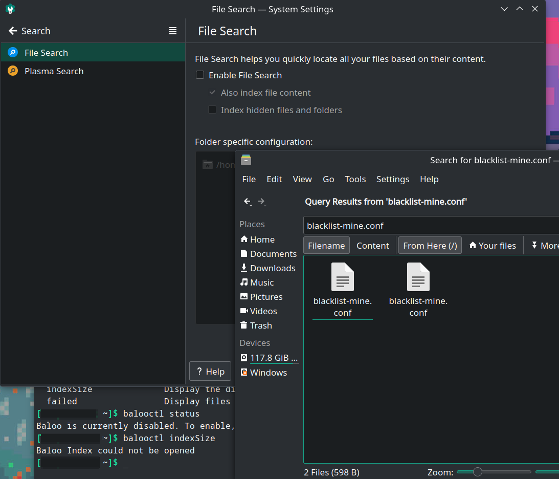

( though it is somewhat odd it is returning 2 entries of the exact same file :thinking: )

kfind seems to work though (i don’t know if this is my fault) i must search for the very exact name, otherwise it wont fnd anything neither. Using Double Commander works fine for searching all kind of files, also searching “my files” instead of “from here” seems to work as well.

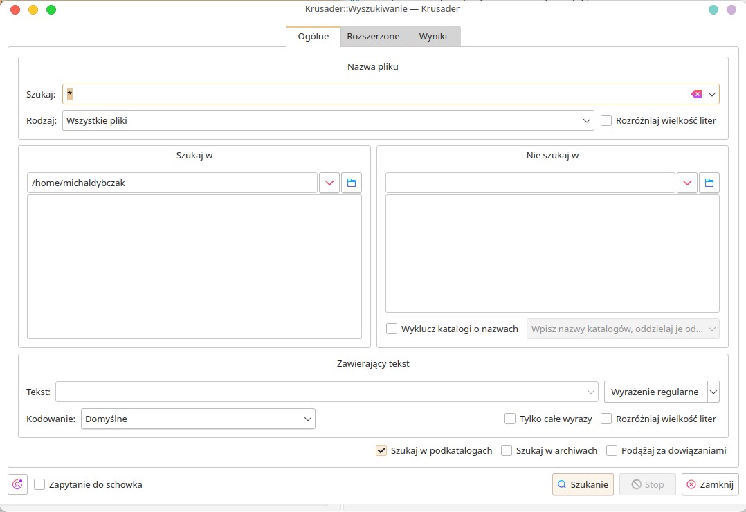

KFind in Dolphin never worked for me too, and I’m using Plasma 8 years… This is why I use only filter to find folders and files in Dolphin, and when I need to do a proper search, I use Krusader which uses an independent search, not relying on any databases.
This is beyond me, why search in Dolphin doesn’t work despite so intense development and bug fixing since few years, but it sucked 8 years ago, and it sucks right now. IMO this should be taken down from Dolphin, because it’s an embarrassment. Even if you know the file is there, it doesn’t find anything. Kursader on the other hand, always delivers.

Another discovery i made is when clicking More Search Tools > More > Configure from the search bar and using kfind… i see that search via database is greyed out, shouldn’t it be able to click? Since Baloo is running?
I don’t know. It isn’t grayed out for me, although my baloo is probably deactivated (can’t remember thou for sure, never needed it and probably deactivated when it started misbehaving).
OK, I found something out. The search requires you to put FULL NAME of the file. Otherwise, it doesn’t find anything. If you have a partial name, use * at the end or the beginning. Then it works. It is counterintuitive. The partial search should be the default and the need to use * shouldn’t be needed. It’s archaic.
So in the example above, when I was searching for “disney” alone, it wasn’t finding anything, but when I used “disney*” it finally did.
Thank you that worked. That way files are found.

Besides the double entry … the interesting thing is that it initially only has one … and duplicates them at the end.
Mine is as well … but I think you are correct it should be available in your case because baloo should be running.
Maybe check it?
balooctl status
