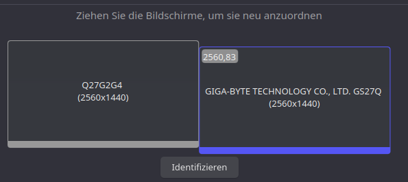

Sorry, my message was a bit confusing. So, I have two monitors, both mounted on a stand for two monitors. But the one on the right is slightly lower. I would now like to change the arrangement of the displays in the system settings so that when I move the cursor from the right to the left or vice versa, it comes out at the same height on the other display. Unfortunately, I can only move the right monitor to at least 80px difference in the system settings. That is too big. I would therefore like to know how I can change this manually via Config. I cannot just put one monitor higher. I would attach a screenshot but it doesn’t let me post it.
I’m trying to change the displays in System Settings Hardware -> Displays and monitors Display setup.

But I can move it in the system settings, but only more than I need. I need about 40px shift, but if I try to move the right monitor minimally downwards in the system settings, it only starts at about 80px, if I try to move it higher, it snaps to the same height as the other one.

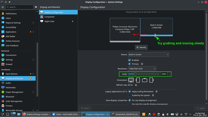

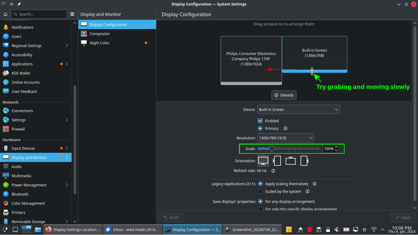

@medmedin seems to be using Wayland. Look at the screenshot for comparison with your X11 counterpart. Wayland had more options; perhaps more fine grained than X11.
Ich hoffe, das erweist sich als hilfreich.
Mouse will move from a monitor to another at the same vertical position (see red arrow), you should change scaling of one monitor to get the same height
When I’m trying to move it slowly it snaps to the top, if I move the cursor slowly to the bottom, its moving at least 83px.
Screenshot_20240104_222839
Thats why I want to edit a config file manually, to set the position of the second monitor to 2560, 40.
