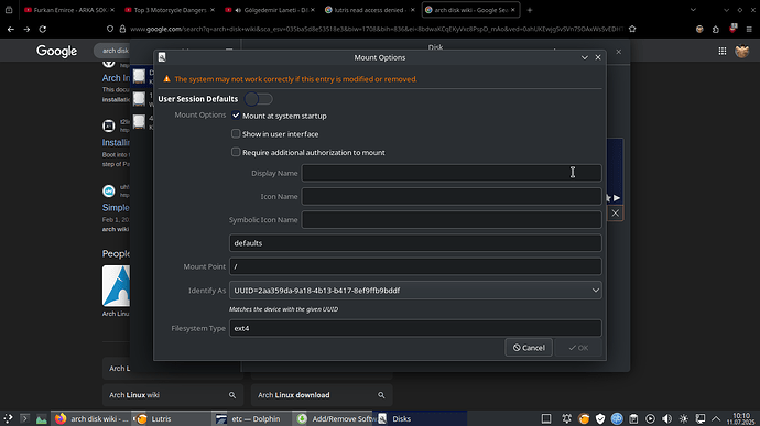

I made newbie mistake. While installing game with lutris, showed read access error then i take ownership with gnome-disk app. Now system disk not able to perform properly. Can i fix this issue, i dont want to install from usb drive again
What is the issue?
The orange message says it MAY not work correctly IF removed.
It doesn’t say it won’t work properly.
This graphical tool potentially alters your /etc/fstab
So:
look what is in there and if you are not sure how to interpret it, show the content here.
cat /etc/fstab
format the output as preformatted text → this button: </>

/etc/fstab looks fine
Only you can know what the last two lines are for, but your / (root partition) is fine.

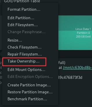

Does it even let you do that? I can’t see any way to do so in your screenshot.
Do you actually have an issue?
Have you taken ownership of the / partition?
ls -l /
Have you tried pacman? It might at least give us some information.
It does, though I have no idea how and I am not brave enough to try as I prefer the regular command line way.
