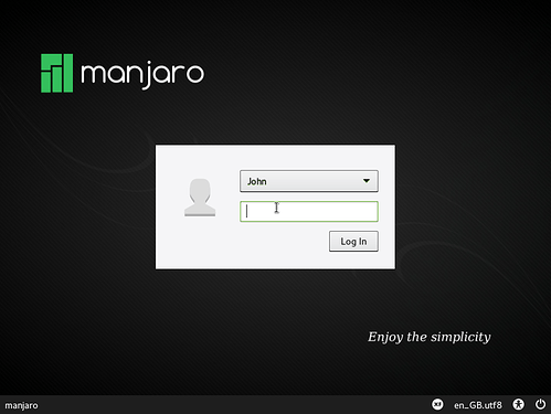

Hi there, how can I disable the login screen? Here’s an example of what I want to remove:
I wish to be able to log into my computer using a terminal-like window. Any tips would be heavily appreciated!

In theory:
sudo systemctl disable lightdm.service
and replace exec $(get_session)
in ~/.xinitrc with exec xfce4
for example. Then you can login in textmode after reboot and type startx to start the DE.
What desktop are you running? I know kde has several options and themes for the login screen, might be something there that’s suitable
I’m using XFCE as my DE
