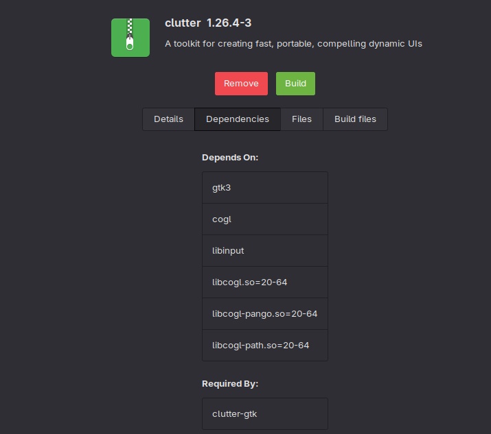

not sure if this helps . but this is what clutter needs. but…
clutter is from AUR
so is clutter-gtk
cogl as well
remove - but not recursively
it wont remove. it keeps hanging on conflicts one needs the other and wont remove :frowning:
not specific enough
but they can all three go
better use pacman to remove - the command line output is easier to post here
