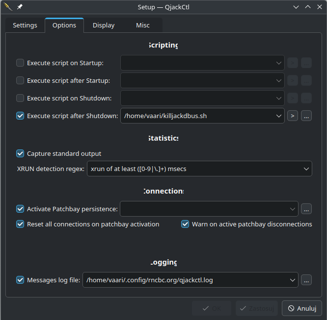

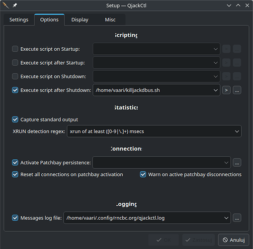

Hi, jack2-dbus and dbus-broker-units are in conflict. Just remove jack2-dbus:
“sudo pacman -Rns jack2-dbus” and restart your system. Or if jackdbus is needed for some reasons, use Qjackctl for “killer script” automatic execution “after suthown”. For me working perfect, system reeboting or powering off quick every time.
~/killjackdbus.sh
#!/bin/sh
killall -9 jackdbus
