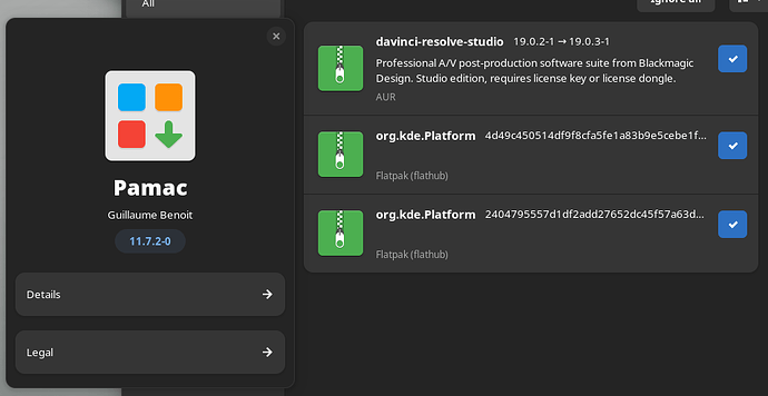

One of my machines upgraded to DRS 1903 and the other failed with the message below. I usually wait for the next release, but find it strange that this version upgraded fine on my HP Z840 and failed on my HP Z820. I have been using DRS on my Z820 for over 5 years. Any thoughts?
All responses are greatly appreciated.

Preparing...
Refreshing AUR...
Cloning davinci-resolve-studio build files...
Generating davinci-resolve-studio information...
Checking davinci-resolve-studio dependencies...
Resolving dependencies...
Checking inter-conflicts...
Building davinci-resolve-studio...
==> Making package: davinci-resolve-studio 19.0.3-1 (Fri 15 Nov 2024 09:56:33 AM CST)
==> Retrieving sources...
-> Found DaVinci_Resolve_Studio_19.0.3_Linux.zip
==> Validating source files with sha256sums...
DaVinci_Resolve_Studio_19.0.3_Linux.zip ... FAILED
==> ERROR: One or more files did not pass the validity check!
Failed to build davinci-resolve-studio

Probably the downloaded file (and therefore the checksum) changed between your two attempted installs.
You can try to pull the created package file from the successful build on your HP Z840 (from package cache) and transfer+install it on your HP Z820.
