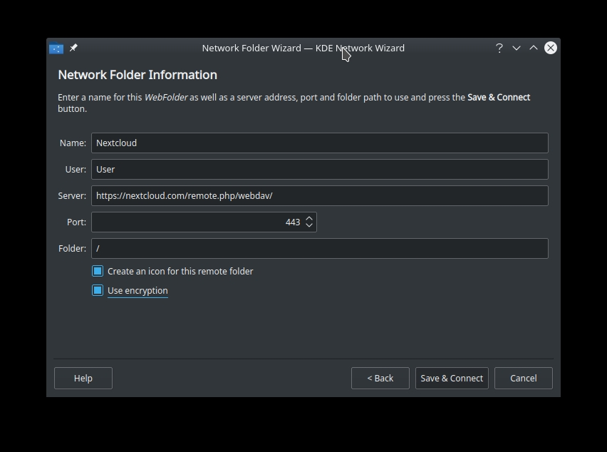

i have tried that $knetattach cmd to setup the webdavs connection, after directly type the
webdavs:://username@file.mywebdavs.org into dolphin address bar not connecting…
it also yield similar result:
something like 'loading folder" & examining the server (something like that). it just stay there for ages.
