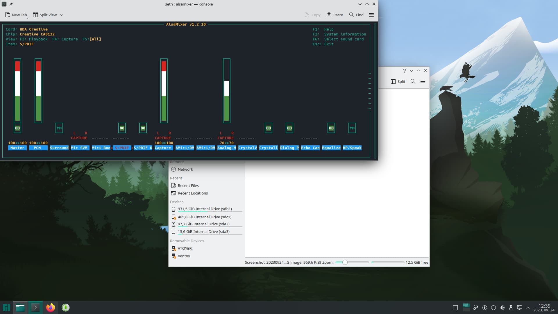

You may can try via terminal and open alsamixer.
Just type alsamixer and you see a little interface where you can choose between your soundcards and switch other options but with the F6 Key you can choose the soundcard.
With Space Key or arrow Keys you can change features.
Which desktop you using could help too. I only have experience with KDE btw.

I started the live system, checked it:
I guess I should look at s/pdif.
I can’t set anything on it.
s/pdif 00
s/pdif default pcm ( off ) mm
S/PDIF mixer controls have a switch to mute [MM] or unmute [OO] output
Use M on keyboard to set mute state to [OO] for S/PDIF and S/PDIF Default PCM
Hi nikgnomic!
I switched both s-pdif. Now they both show 00. I have got this far, but unfortunately still no sound.

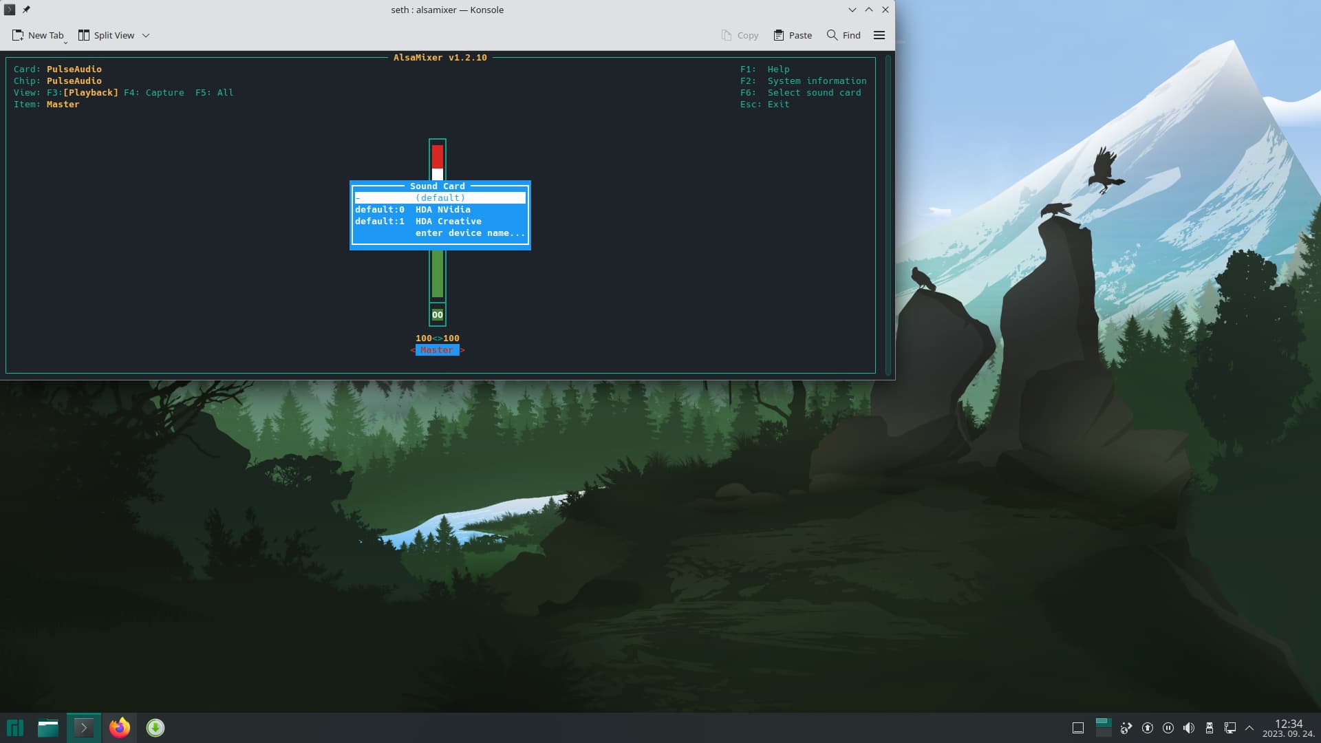

Did you choosed your Soundcard?

Maybe upload some screenshots from your Alsamixer options.

I uploaded some pictures, but the forum won’t let me link to them. I registered yesterday, probably because…

Screenshots in post 8 & 10 are showing KDE audio controls not PulseAudio Volume Control
I suggest you install pavucontrol-qt to work around any potential bug in KDE audio controls
