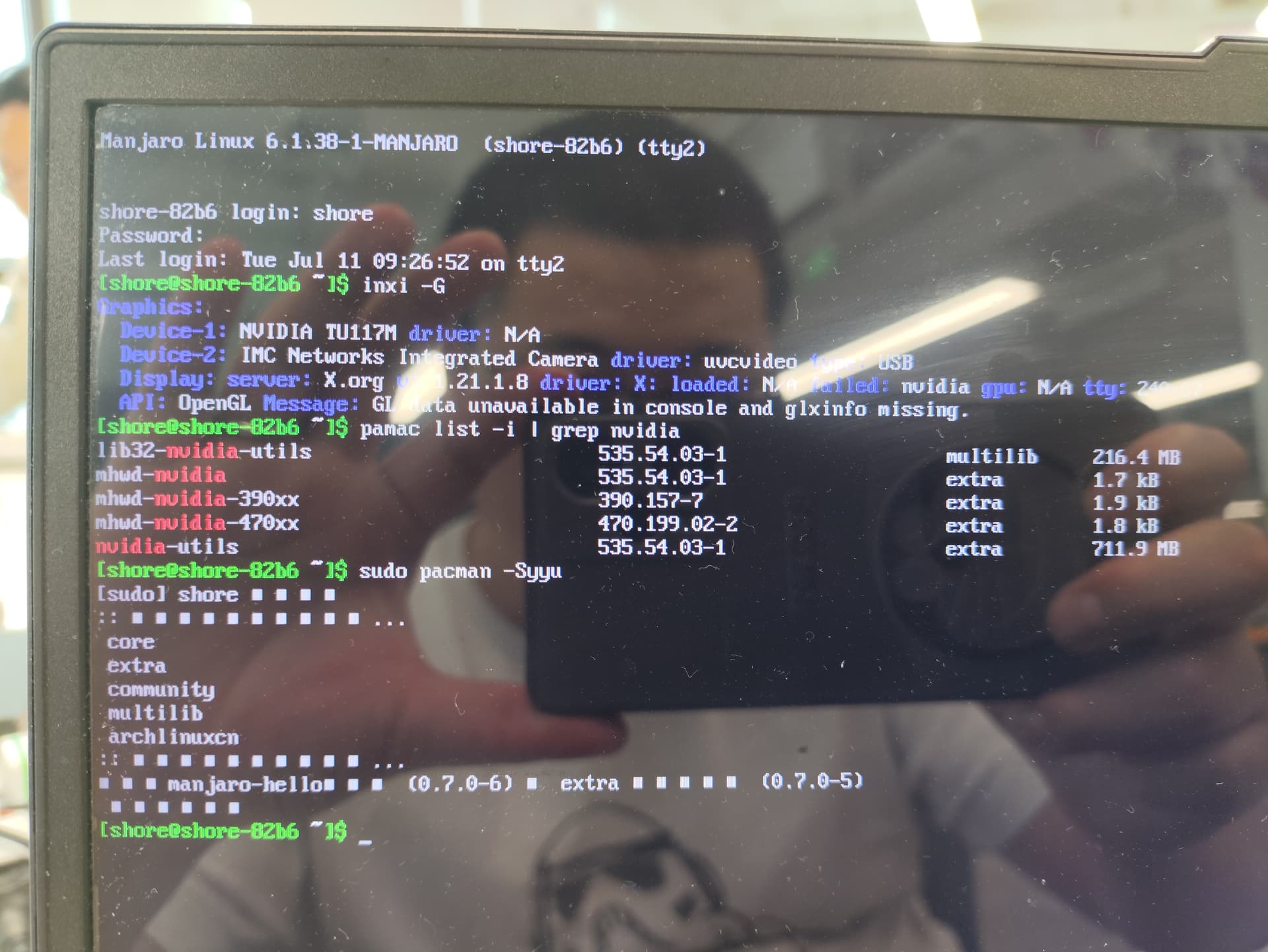

Hi I just updated my manjaro and it crashed after update, no terminal or graphic shows only with the following shows on the screen
it seems that the nvidia drive was replaced…
I have lots of things saved in that system and really need it…
Anyone help pls, thanks!!

hi i tried and got an error msg after startx
which says no screen found

One thing I notice is your kernel is EOL.
Since you can get to runlevel 3 or similar…
Then you will want to first boot into a different kernel.
If you dont have one installed…
sudo mhwd-kernel -i linux61
Then reboot
systemctl reboot
Grub should allow you to select kernel at boot - if you dont see it then try hitting Esc
You can check current running kernel with … uname -r
Then proceed to remove the EOL kernel …
sudo mhwd-kernel -r linux62
And do updates for good measure:
sudo pacman -Syu
Then reboot and check

seems not work, reverted to linux61 and still no graphic.
my graphic card is gtx1650, the current info says it does not have a driver
the pacman -Syyu doesn’t up grade…

To reinstall the driver you could
sudo mhwd -f -i pci video-nvidia

it seems like the one of the pkg (maybe psensor) blocked the upgrade of nvidia driver

i did, psensor need libxvnctrl, which actually blocked the reinstall of nvidia
