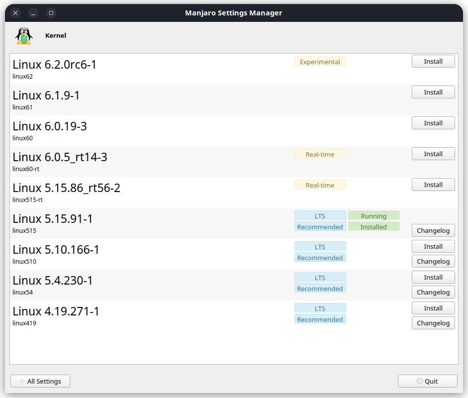

Feb 3rd was when the Kernel patch happens however the controller was still working fine up until about a day ago so I’m not sure which package caused the issue. I currently do not have any other kernel version installed. As shown here.
I would appreciate if I can get some help here. If you have any ideas please do.
