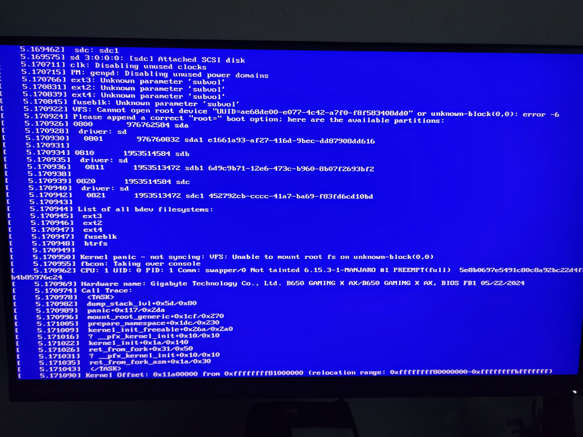

In short, my computer is no longer able to boot past the Grub screen, failing to load a kernel and/or possibly being unable to detect a valid filesystem from the UUID of my BTRFS boot disk. This is a 1tb nvme drive on which I was performing some (perhaps unwise) optimizations via the use of beesd in an attempt to retake some disk space.
I have been able to confirm the sanctity of the disk contents at least, and am able to (more or less) access all device contents from a bootable recovery thumbdrive. What I cannot seem to do, sadly, is boot into the nvme itself. All snapshots fail, as does the primary loaded image. It seems that all kernels fail to boot in this manner.
After grub begins, there is an error that indicates it may not have been able to list the partitions from the nvme drive, as the other sd’s all show up as potential options. Not 100% sure what to make of that.
Things that have worked:
  • Manually mounting the device from the recovery disk
  • chroot into mounted nvme drive
  • accessing any data on the same
Things I have tried, and that have failed:
  • manually updating brub config during boot to try different options / see if I can designate the device in a way that is not uuid (relative device path from root, device name, etc.)
  • pacman -Syu finds no updates
  • mkinitcpio -P && update-grub, reboot does not manage to fix the issue
  • btrfs check /dev/nvme0n1p2 reports no errors found
  • chrooted mhwd-kernel -i linux615 failed to boot. Images appeared to be created correctly, and neither mkinitcpio nor grub reported any notable errors.
Any advice and suggestions would be appreciated. Happy to provide additional system configurations as needed. It is a little difficult to capture the error screen at this time as it requires me to reboot my computer, so please bear with me when those are required.

Edit: I was running kernel 6.15, but neither it nor 6.12 could boot.
mhwd-kernel -li
Currently running: 6.12.28-1-MANJARO (linux612)
The following kernels are installed in your system:
   * linux612
   * linux615
   * linux66
cat /etc/lsb-release (chroot)
DISTRIB_ID="ManjaroLinux"
DISTRIB_RELEASE="25.0.4"
DISTRIB_CODENAME="Zetar"
DISTRIB_DESCRIPTION="Manjaro Linux"
lsblk -fa (recovery, nvme0n1 is the boot drive)
NAME        FSTYPE      FSVER            LABEL            UUID                                 FSAVAIL FSUSE% MOUNTPOINTS
loop0       squashfs    4.0                                                                          0   100% /run/miso/sfs/livefs
loop1       squashfs    4.0                                                                          0   100% /run/miso/sfs/mhwdfs
loop2       squashfs    4.0                                                                          0   100% /run/miso/sfs/desktopfs
loop3       squashfs    4.0                                                                          0   100% /run/miso/sfs/rootfs
sda
└─sda1      crypto_LUKS 2                                 2caf01d7-d678-4560-8ab0-97ee014e6b24
sdb
└─sdb1      crypto_LUKS 2                                 353e5db4-1604-4114-ad82-77d142c94eb6
sdc
└─sdc1      crypto_LUKS 2                                 ee68c45d-5eb2-4db1-aeaa-69016b1be7e1
sdd         iso9660     Joliet Extension MANJARO_KDE_2503 2025-05-26-07-05-21-00                     0   100% /run/miso/bootmnt
├─sdd1      iso9660     Joliet Extension MANJARO_KDE_2503 2025-05-26-07-05-21-00
└─sdd2      vfat        FAT12            MISO_EFI         EB01-4A96
nvme0n1
├─nvme0n1p1 vfat        FAT32                             48C8-AA11
├─nvme0n1p2 btrfs                        rootSSD          ae68de00-e077-4c42-a7f0-f8f583408dd0  372.3G    58% /mnt/btrfs
│                                                                                                             /mnt/.snapshots
│                                                                                                             /mnt/var/tmp
│                                                                                                             /mnt/var/log
│                                                                                                             /mnt/var/cache
│                                                                                                             /mnt/usr/local
│                                                                                                             /mnt/opt

After some digging I found another user that had a similar issue. Things aren’t looking too good tbh. After update blue screen
It is a tool that should be used with caution - and only from within a chroot as it is an offline tool.
bees is a block-oriented userspace deduplication agent designed to scale up to large btrfs filesystems. It is an offline dedupe combined with an incremental data scan capability to minimize time data spends on disk from write to dedupe.
– GitHub - Zygo/bees: Best-Effort Extent-Same, a btrfs dedupe agent
btrfs is not like most other file systems - one has to understand how it work to realise how it should be used.
Because it is copy-on-write feature - it will quickly run full if you add and remove a lot of files in a short period of time - which will lead to the thought that disk is exhausted an you need to do maintenance.
The kernel is looking for your btrfs root subvolume on an ext4 filesystem. In other words, you most likely have the wrong UUID for the root filesystem in /etc/fstab and in /etc/default/grub.
That shouldn’t be it.

I was able to mess around a little bit in the grub cli, but I wasn’t quite able to get to a point where it would properly boot into root. The closest I got was actually a loading screen, but after then it wasn’t able to correctly load the root volume as it wasn’t defined in the boot parameters. Then again, defining more than vmlinuz and root crashes with a page alloc error, so that seems a pretty dead end.
In re. the blue screen/kernel panic, it appears that the nvme isn’t listed at all? I’m wondering if there was some sort of issue and the relevant driver failed to get loaded into the image or kernel? I’m not sure how to investigate that at this time though.
This is rather useless in this context, given this does no data integrity checking. And you just ran a tool to attempt to de-dupe data.
You need to run a scrub of the data to validate it for this step. (e.g. sudo btrfs scrub start /dev/nvme0n1p2, and status to see the progress, kernel logs contain errors. )
Once there, we can see if there is anything to boot from.

That is really bizarre, like it’s trying to boot the btrfs device as an ext partition? Which is hard to see… The rest of that is in dmesg… (Rather than taking pics of your monitor as you seem to know how to get text out of a chroot’d environment. If there is anything of relevance there…)
After you run mhwd-kernel -i .. (you said with no errors), what is the contents of /boot/grub/grub.cfg ?)

On the most recent boot – which was dated yesterday – was able to identify the nvme without issues.
Jun 25 08:35:17 manjaro kernel: loop: module loaded
Jun 25 08:35:17 manjaro kernel: device-mapper: uevent: version 1.0.3
Jun 25 08:35:17 manjaro kernel: device-mapper: ioctl: 4.48.0-ioctl (2023-03-01) initialised: dm-devel@lists.linux.dev
Jun 25 08:35:17 manjaro kernel: ACPI: video: Video Device [VGA] (multi-head: yes  rom: no  post: no)
Jun 25 08:35:17 manjaro kernel: input: Video Bus as /devices/LNXSYSTM:00/LNXSYBUS:00/PNP0A08:00/device:20/LNXVIDEO:00/input/input2
Jun 25 08:35:17 manjaro kernel: cryptd: max_cpu_qlen set to 1000
Jun 25 08:35:17 manjaro kernel: nvme 0000:02:00.0: platform quirk: setting simple suspend
Jun 25 08:35:17 manjaro kernel: nvme nvme0: pci function 0000:02:00.0
Jun 25 08:35:17 manjaro kernel: r8169 0000:08:00.0 eth0: RTL8125B, 74:56:3c:b8:e7:00, XID 641, IRQ 82
Jun 25 08:35:17 manjaro kernel: r8169 0000:08:00.0 eth0: jumbo features [frames: 9194 bytes, tx checksumming: ko]
Jun 25 08:35:17 manjaro kernel: nvme nvme0: allocated 78 MiB host memory buffer.
Jun 25 08:35:17 manjaro kernel: nvme nvme0: 12/0/0 default/read/poll queues
Jun 25 08:35:17 manjaro kernel: usb 1-3.4: New USB device found, idVendor=046d, idProduct=c08b, bcdDevice=27.03
Jun 25 08:35:17 manjaro kernel: usb 1-3.4: New USB device strings: Mfr=1, Product=2, SerialNumber=3
Jun 25 08:35:17 manjaro kernel: usb 1-3.4: Product: G502 HERO SE
Jun 25 08:35:17 manjaro kernel: usb 1-3.4: Manufacturer: Logitech
Jun 25 08:35:17 manjaro kernel: usb 1-3.4: SerialNumber: 096138723434
Jun 25 08:35:17 manjaro kernel:  nvme0n1: p1 p2 p3
On the 23rd and 24th though… it’s essentially this non-stop.
Jun 23 11:03:21 everest systemd-journald[427]: Under memory pressure, flushing caches.
Jun 23 12:04:57 everest kernel: nvme nvme0: I/O tag 0 (7000) opcode 0x1 (Write) QID 8 timeout, aborting req_op:WRITE(1) size:16384
Jun 23 12:04:57 everest kernel: nvme nvme0: I/O tag 1 (1001) opcode 0x1 (Write) QID 8 timeout, aborting req_op:WRITE(1) size:16384
Jun 23 12:04:57 everest kernel: nvme nvme0: I/O tag 2 (1002) opcode 0x1 (Write) QID 8 timeout, aborting req_op:WRITE(1) size:16384
Jun 23 12:04:57 everest kernel: nvme nvme0: I/O tag 3 (6003) opcode 0x1 (Write) QID 8 timeout, aborting req_op:WRITE(1) size:16384
Jun 23 12:04:57 everest kernel: nvme nvme0: Abort status: 0x0
Jun 23 12:04:57 everest kernel: nvme nvme0: I/O tag 93 (005d) opcode 0x1 (Write) QID 8 timeout, aborting req_op:WRITE(1) size:16384
Jun 23 12:04:57 everest kernel: nvme nvme0: I/O tag 94 (305e) opcode 0x1 (Write) QID 8 timeout, aborting req_op:WRITE(1) size:16384
Jun 23 12:04:57 everest kernel: nvme nvme0: I/O tag 95 (305f) opcode 0x1 (Write) QID 8 timeout, aborting req_op:WRITE(1) size:16384
Jun 23 12:04:57 everest kernel: nvme nvme0: I/O tag 118 (b076) opcode 0x1 (Write) QID 8 timeout, aborting req_op:WRITE(1) size:16384
Jun 23 12:04:57 everest kernel: nvme nvme0: I/O tag 151 (5097) opcode 0x1 (Write) QID 8 timeout, aborting req_op:WRITE(1) size:16384
Jun 23 12:04:57 everest kernel: nvme nvme0: I/O tag 152 (e098) opcode 0x1 (Write) QID 8 timeout, aborting req_op:WRITE(1) size:16384
Jun 23 12:04:57 everest kernel: nvme nvme0: I/O tag 153 (4099) opcode 0x1 (Write) QID 8 timeout, aborting req_op:WRITE(1) size:16384
Jun 23 12:04:57 everest kernel: nvme nvme0: I/O tag 154 (f09a) opcode 0x1 (Write) QID 8 timeout, aborting req_op:WRITE(1) size:16384
Jun 23 12:04:57 everest kernel: nvme nvme0: I/O tag 167 (50a7) opcode 0x1 (Write) QID 8 timeout, aborting req_op:WRITE(1) size:32768
Jun 23 12:04:57 everest kernel: nvme nvme0: I/O tag 168 (e0a8) opcode 0x1 (Write) QID 8 timeout, aborting req_op:WRITE(1) size:16384
Jun 23 12:04:57 everest kernel: nvme nvme0: I/O tag 169 (a0a9) opcode 0x1 (Write) QID 8 timeout, aborting req_op:WRITE(1) size:16384
Jun 23 12:04:57 everest kernel: nvme nvme0: I/O tag 170 (d0aa) opcode 0x1 (Write) QID 8 timeout, aborting req_op:WRITE(1) size:16384
Jun 23 12:04:57 everest kernel: nvme nvme0: I/O tag 171 (30ab) opcode 0x1 (Write) QID 8 timeout, aborting req_op:WRITE(1) size:16384
Jun 23 12:04:57 everest kernel: nvme nvme0: I/O tag 172 (30ac) opcode 0x1 (Write) QID 8 timeout, aborting req_op:WRITE(1) size:16384
Jun 23 12:04:57 everest kernel: nvme nvme0: I/O tag 0 (7000) opcode 0x1 (Write) QID 8 timeout, reset controller
Jun 23 12:04:57 everest kernel: nvme nvme0: 12/0/0 default/read/poll queues
Jun 23 12:33:22 everest kernel: nvme nvme0: I/O tag 0 (0000) opcode 0x1 (Write) QID 5 timeout, aborting req_op:WRITE(1) size:16384
Jun 23 12:33:52 everest kernel: nvme nvme0: I/O tag 1 (e001) opcode 0x1 (Write) QID 5 timeout, aborting req_op:WRITE(1) size:16384
Jun 23 12:33:52 everest kernel: nvme nvme0: I/O tag 2 (b002) opcode 0x1 (Write) QID 5 timeout, aborting req_op:WRITE(1) size:16384
Jun 23 12:33:52 everest kernel: nvme nvme0: I/O tag 3 (e003) opcode 0x1 (Write) QID 5 timeout, aborting req_op:WRITE(1) size:16384
Jun 23 12:33:52 everest kernel: nvme nvme0: Abort status: 0x0
Jun 23 12:33:52 everest kernel: nvme nvme0: I/O tag 0 (0000) opcode 0x1 (Write) QID 5 timeout, reset controller
Actually, I didn’t add that update. When I was messing around with manually attempting to boot grub, I got a grub_efi_drop_alloc() called with wrong page count error whenever I provided more that the basic 2 values in the linux prompt. I had nearly managed a boot but encountered an error indicating that root wasn’t properly mounted (which makes sense because the subvol option wasn’t passed).
Like this:
grub> linux /@/boot/vmlinuz-6.12-x86_64 root=UUID=[nvme-uuid]
Aborted. Press any key to exit.
Edit: well, that one fails anyways with just the two, but it’s consistent on that step
