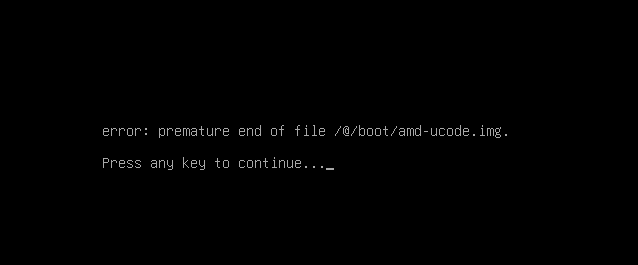

Cinnamon installer is broken when selecting BTRFS
Cinnamon version fails to boot when selecting BTRFS during install.
Tested on several machines and also tested other Manjaro Cinnamon spins and same result. Installer is broken for BTRFS installations.
See screenshot. That is what you get when trying to boot after installation.

Using the Erase Disk partitioning method; which presumedly was also used by the OP.
Confirming an error on first (and subsequent) boots…
error: start_image() returned 0x8000000000000001.
  Failed to boot both default and fallback entries.
After a few seconds the Grub menu presents, but fails to continue automatic booting. Activating the first entry with a keypress fails, with the following error:
error: you need to load the kernel first.
Not the error the OP describes;
error: premature end of file /@/boot/amd-ucode.img.
but an issue nonetheless. :eyes:

However, @kwag also reports the same btrfs problem with the SbK spin, which uses the same calamares installer as all Manjaro editions. Therefore, switching to a different ISO is probably not going to make any difference, and I think I know where the problem lies. :thinking:
The thing is that the kernel images and initcpios are stored under /boot, and if /boot is on the root filesystem — as opposed to on a separate partition — then with the root filesystem being btrfs, naturally, the contents of /boot will be living on btrfs as well.
In and of itself, this is not a problem, but the regular grub does not support this, because grub — which needs to load the kernel image and initramfs (including the microcode file) into RAM — does not support sparse files, which are part and parcel of the copy-on-write principle of btrfs.
So, the solution would be to either…
  • disable copy-on-write on the initramfs and microcode files via chattr — see the man page; or…
  • use grub-btrfs instead of the regular grub; or…
  • use a separate partition formatted as ext4 for /boot — which is how I myself have done it here; or…
  • don’t use btrfs altogether.

It’s a known issue with Calmares 3.3. I switched it back to 3.2 earlier, but had forgotten to spin a new ISO.
Here’s a new one: manjaro-cinnamon-24.0.2-240710-linux69.iso (Yes, I know it should be 24.0.3).
EDIT: Now available on the official download page.
Sure! For small files like in /etc, it’s fast. However, no misconception that if you CRASH a big /usr like folder or if you also keep /home as a BTRFS snapshot, then get ready to wait a long time for your rsync restore. The simple test is this. How long does it take to do an initial EXT4 snapshot? a LOT! How long does it take the same on BTRFS? Zero! It’s an atomic operation.
A BIG Thank YOU! :raised_hands:
Installed and booted like a champ!
