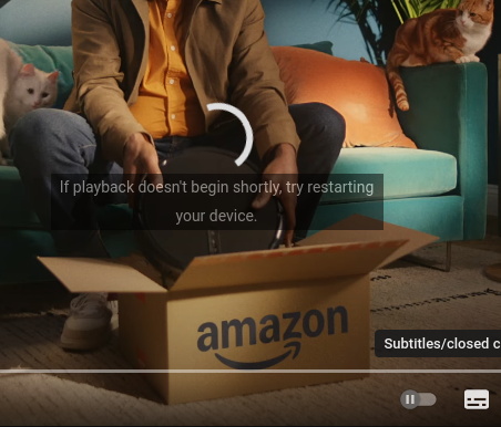

Can't stream videos: firefox, chromium after update
I do not know what might be the problem but I can not stream video on neither firefox or chromium. I have tried Netflix, youtube and disney+. The same problem on all.
I can scroll, I can just not make the video play it just looks like it is buffering.
Suggestions?

Should I clean up something after this or done it some other way? I use pulsaudio-ctl all the time and it still works now.
Now streaming on youtube works but not Netflix. I have an error code e100 which means according to netflix “it is an issue with data stored on your device stops Netflix from playing”.
Suggestions?
