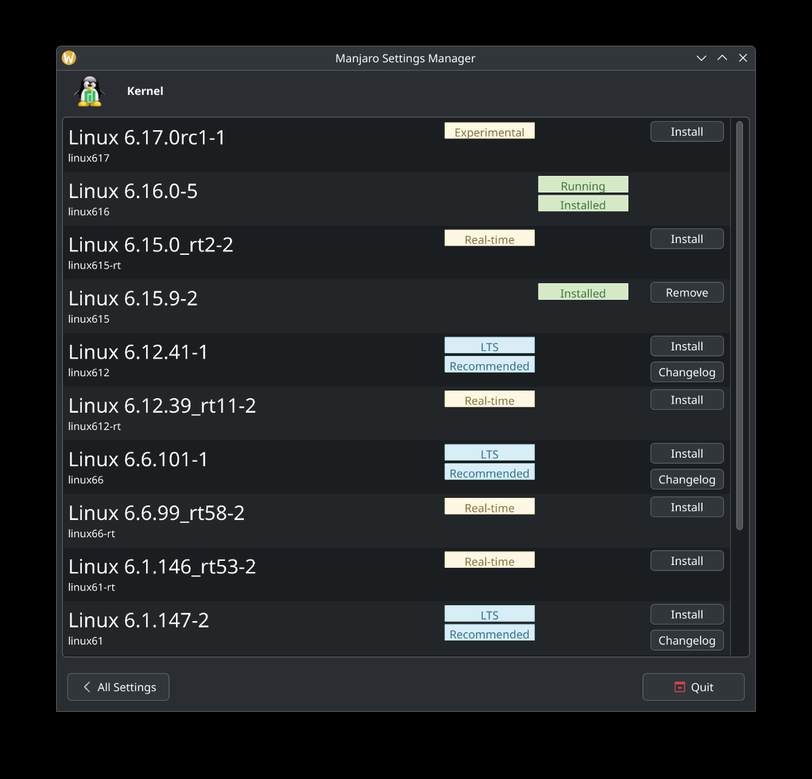

Has nothing to do with that. It is a package automatically installed by the kernel installer. I did not manually install the meta package. I was using Manjaro tools to install it. If Manjaro tools are broken in this regard, that is what I am reporting.
Typical Linux people. If you didn’t do XYZ, you are the one at fault.

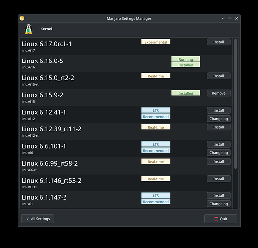

In addition, after looking at the package installer, their seems to be no equivelent for 6.16. So many things broken here. If you install the Meta package, it pulls in 6.15. This is why i was asking if I clear this out if it breaks something as it is the only option.
So yes, I looked at the manual route. So would that also not be ‘broken’?
I am irritated the way you I assumed I didn’t do something.
Removing the Meta packages, which I did not install and an update must have installed, fixed the problem.
I tested adding 6.15 back in through the tool I mentioned above, and I was able to remove it. Someone on the Dev team has fixed it but I cannot say when it was fixed.
Will mark this one solved.
No, they are not broken. As explained to you already, the meta package exists so as to make sure you will always have a bootable kernel installed if your current kernel goes EOL.
And that’s exactly what’s going to happen with 6.15 in a short while. So when 6.15 is declared EOL, the meta package will pull in 6.16 or 6.17.
