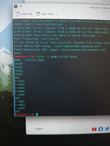

I did this multiple times and it has no update when i run pacman -Syu
The inital error no longer shows up, i assume it works, yet now upon restarting i always redirected to my bios.
I tried to follow the steps in here
But I don’t understand about pointing /etc/fstab with the correct UUID as wheni did lsblk -o NAME,FSTYPE,UUID it doesn’t show any UUID like below
I dont dual boot and manjaro is the only os installed. I’m thinking clean reinstall as my last resort and it wouldbe very helpfull if the issue could be resolved other ways. Any help is appreciated

As it didn’t boot at all I first checked if grub loaded properly by chrooting via live media and changed GRUB_TIMEOUT_STYLE=hidden into GRUB_TIMEOUT_STYLE=menu in /etc/default/grub and update the configuration with update-grub. Restarted my machine and grub does loaded, yet there’s no Manjaro listed at all.
Skipping a lot of following tutorial, I found this particular error questionable
[manjaro /]# mhwd-kernel -li
Currently running: 6.6.10-1-MANJARO (linux66)
The following kernels are installed in your system:
error: could not open file /var/lib/pacman/local/okular-24.02.2-1/desc: No such file or directory
   * linux66
then I tried to reinstall the kernel with
pacman -S linux66
grub-mkconfig -o /boot/grub/grub.cfg
and after a restart the manjaro able to start normally. I still have no idea why it works, maybe there’s a corrupt in the kernel or something.
