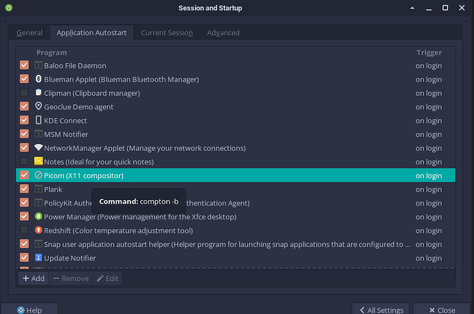

It’s all completely the same as in the guide I’ve linked, except I tried to change picom version, but it did nothing.
According to thee ubuntu forums:
Open the XFCE settings manager: settings manager > session and startup > application autostart > add and add compton -b. Now compton will start automatically when you login.
It was already there since I created ~/.config/autostart/picom.desktop
