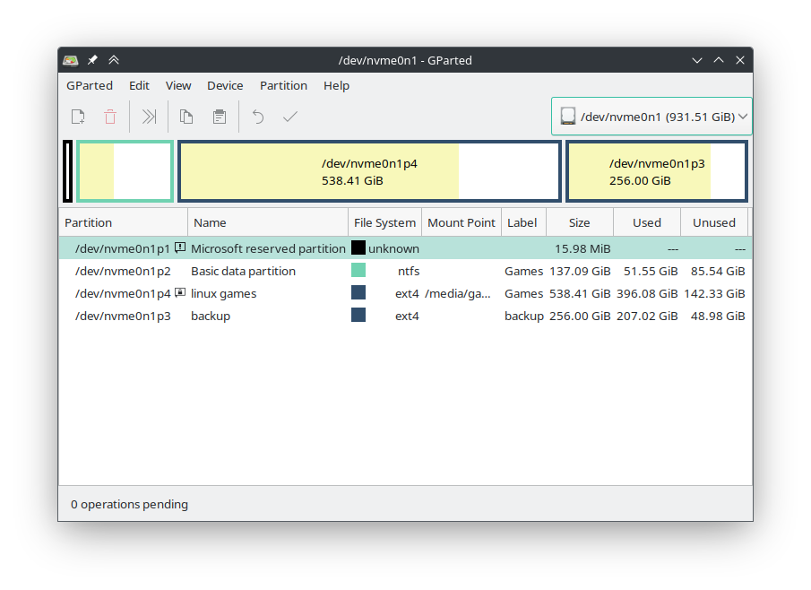

That looks like an MBR partitioned disk? (extended?)

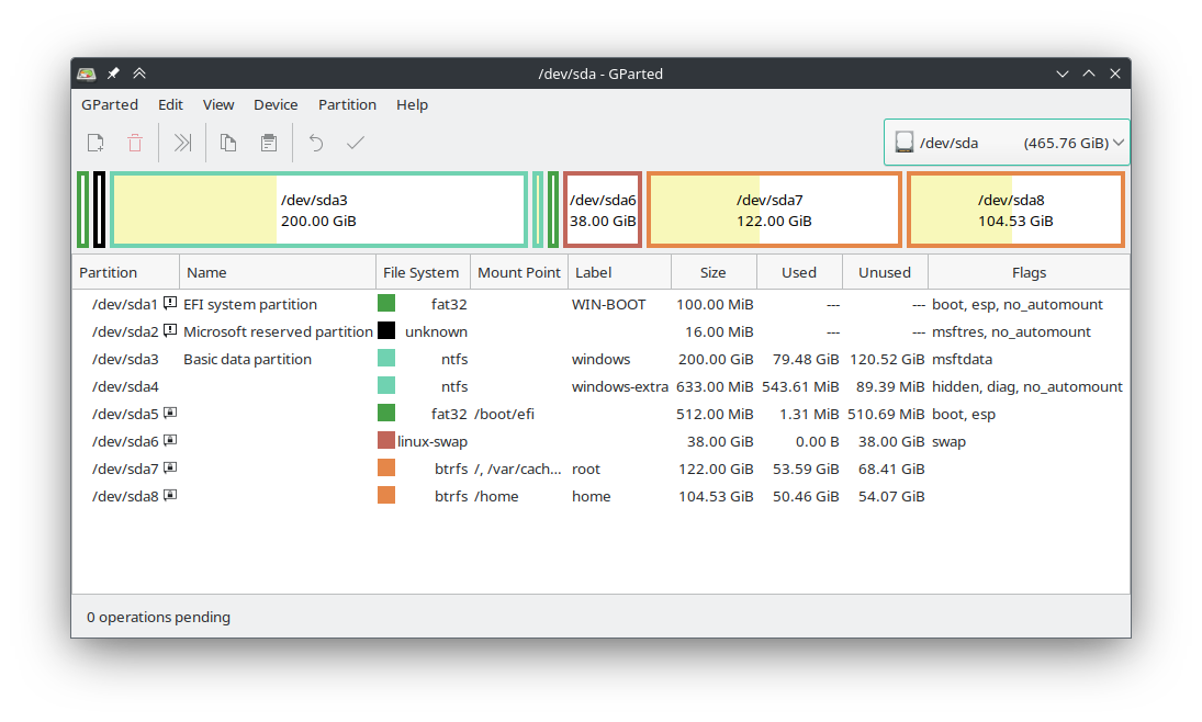

GPT I think would look something like this: (I have both win11 and manjaro on the same drive, but separated boot partitions)
Also, what is that strange curling logo in the top left of your window? xD

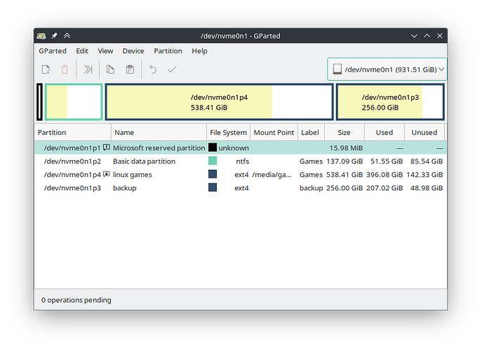

Edit

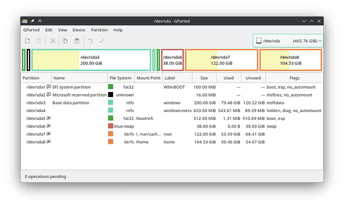

Maybe this picture is better since it actually IS a nvme and no btrfs that might confuse you:
Always leave those microsoft unknown and reserved partitions alone, they are for the restore stuff in windows.
If you create a disk/partition on windows11, it will become GPT.
I believe the OP will find the dropdown and the toolbar (Device) in the same location without additional images; unless, of course, the instructions to create a new GPT partition table were somehow insufficient.
Once the partition table has been created, nothing else needs to be done in GParted. The OP can continue to install Manjaro on the newly prepared drive, as was their original intention.
