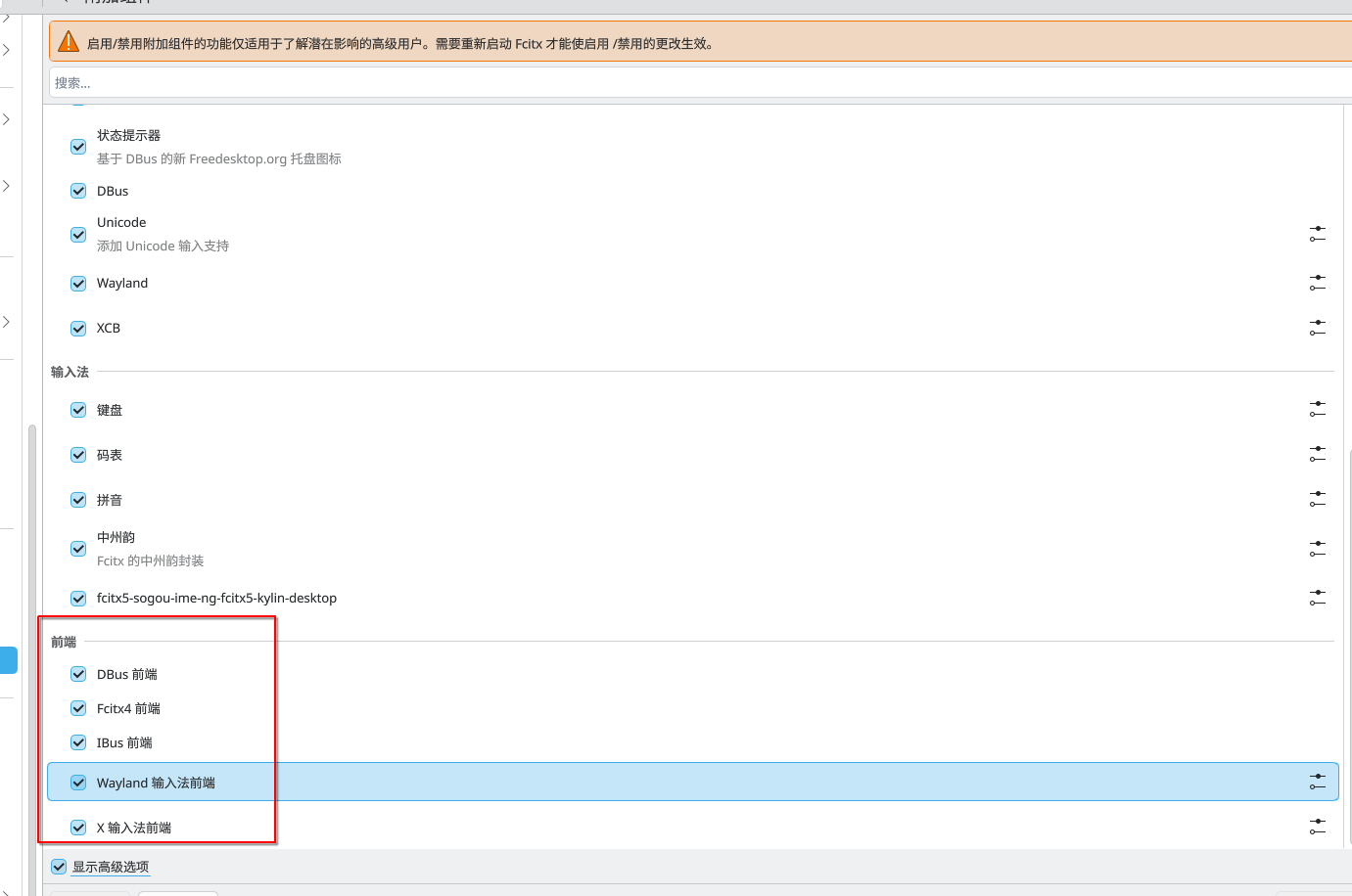

Hi I’m transferring to manjaro KDE, I cannot type Chinese even if I installed fcitx5.
Package I installed:
  1. fcitx5
  2. fcitx5-configtool
  3. fcitx5-chinese-addon
  4. fcitx5-gtk
  5. fcitx5-qt
  6. fcitx5-rime
I can only type Chinese in edge, but including vscode, kwrite, mousepad and other local applications I cannot type Chinese.
I don’t know why and seeking for help, thanks a lot!

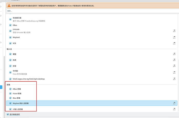

Hi thanks a lot for reply, I just figured it out that I somehow I should enable all the frontend, then the problem gone..
Still very thank you for helping and reply~~
