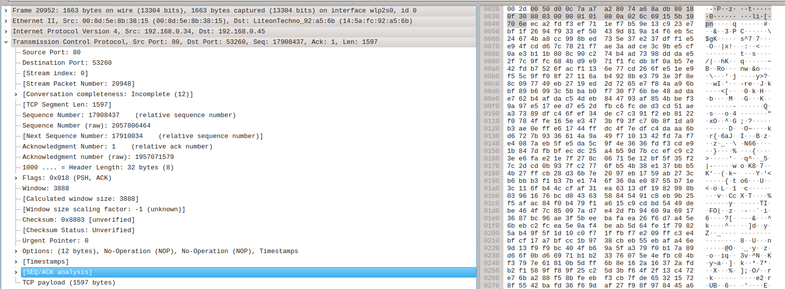

When I look at the TCP throughput with wireshark, I see an average of about 3.5 Mbit/s from the camera to my laptop.
