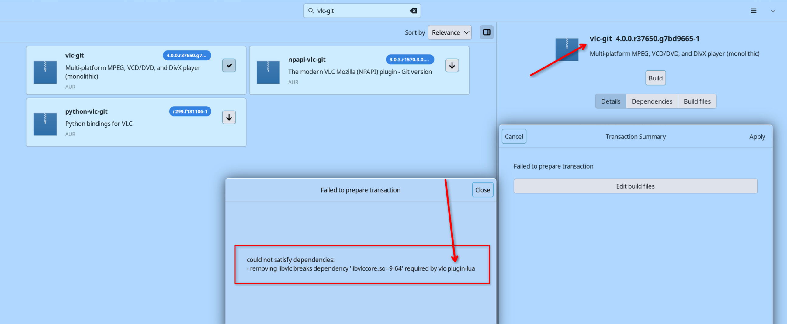

Hi all,
I’m trying to install VLC 4.0 (vlc-git) but I receive an error saying it breaks vlc-plugin-lua
What is the correct procedure for replacing VLC 3 with VLC 4?

Hi @Ben and @cfinnberg
Uninstalling vlc-plugin-lua using pacman removes also vlc, vlc-plugins-all and vlc-gui-qt
[mirto@bianco500 ~]$ sudo pacman -Rc vlc-plugin-lua
[sudo] password di mirto:
controllo delle dipendenze in corso...
:: vlc-cli richiede facoltativamente vlc-plugin-lua: for Lua scripting plugins
Pacchetti (4) vlc-3.0.23_2-7  vlc-gui-qt-3.0.23_2-7  vlc-plugins-all-3.0.23_2-7  vlc-plugin-lua-3.0.23_2-7
Dimensione totale dei pacchetti rimossi:  46,23 MiB
:: Vuoi rimuovere questi pacchetti? [S/n]
:: Elaborazione delle modifiche al pacchetto...
(1/4) rimozione in corso di vlc                                                                                                 [##############################################################################] 100%
(2/4) rimozione in corso di vlc-plugins-all                                                                                     [##############################################################################] 100%
(3/4) rimozione in corso di vlc-gui-qt                                                                                          [##############################################################################] 100%
(4/4) rimozione in corso di vlc-plugin-lua                                                                                      [##############################################################################] 100%
:: Esecuzione degli hook di post-transazione...
(1/4) Arming ConditionNeedsUpdate...
(2/4) Updating icon theme caches...
(3/4) Updating the desktop file MIME type cache...
(4/4) Updating the vlc plugin cache...
At this point pamac-manager allow me to install vlc-git and identifies all the orphaned plugins removing them
Thanks to all

Possibly, when vlc v4 hits the repos, Arch will separate the plugins from the package so they can be installed separately (if that is possible).
Thanks @scotty65
VLC 4 have some problems with some files (different files with the same extensions one opens correctly the other crashes vlc)
On bare metal there is no relefant difference in video play.
So I’m returning to VLC 3
__
UPDATE
Returning to VLC3 was solved with these commands (the trick was -dd )
sudo pacman -Rsn -dd vlc-git
sudo pacman -S vlc
sudo pacman -S vlc-plugins-all
Thanks
