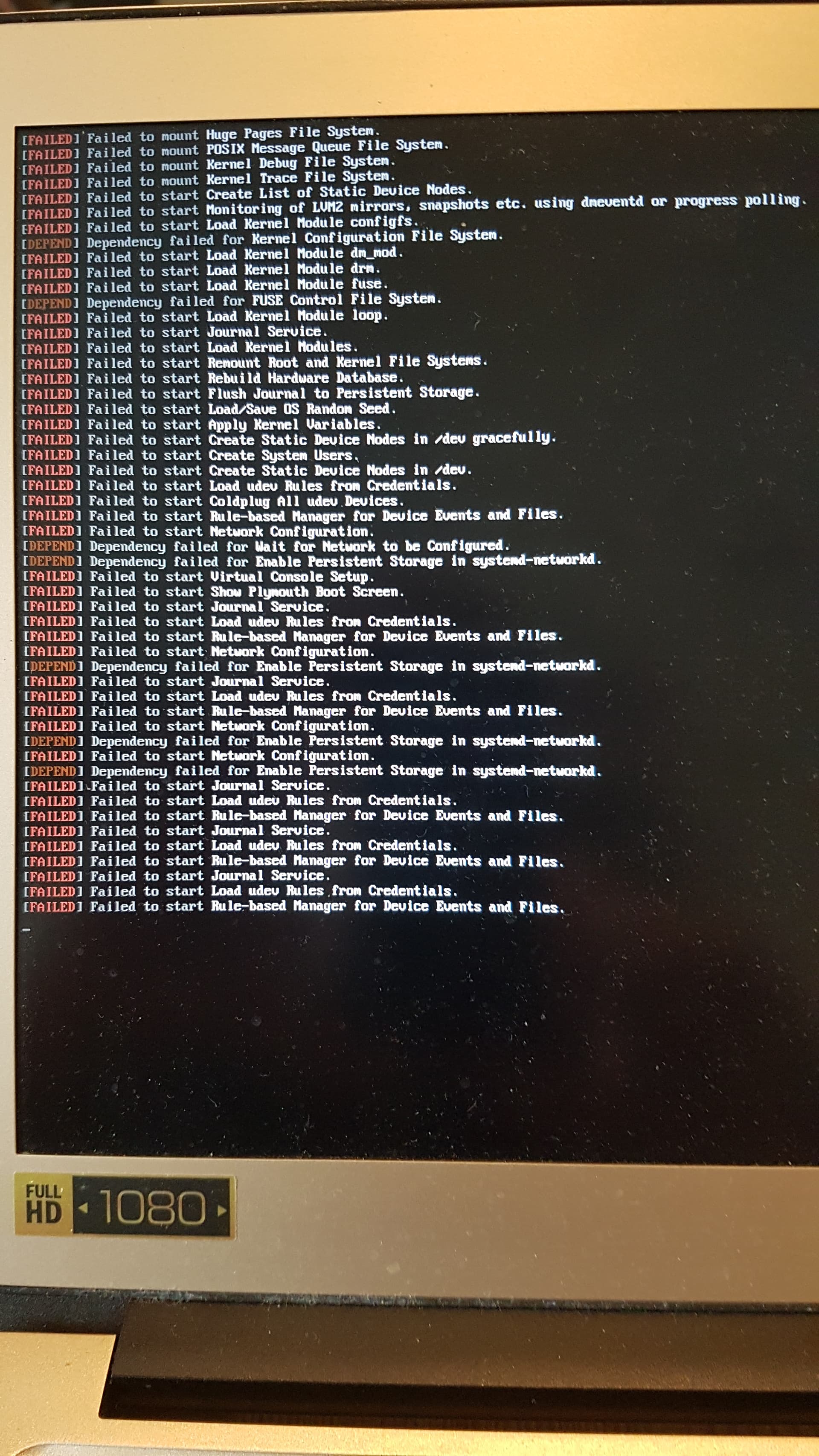

After updating the system on 2024-07-07, I can no longer boot it. There appear a lot of error messages, starting with these lines:
[FAILED] Failed to mount Huge Pages File System.
[FAILED] Failed to mount POSIX Message Queue File System.
[FAILED] Failed to mount Kernel Debug File System.
and a lot more. I have an XUbuntu Live system on a USB Pendrive handy, with which I already did the following:

Okay, so here is my boot up - I attach it as image, because I am afraid it is not useful. It rather looks like a tons of follow-up errors.

In the meanwhile, I reinstalled all the packages which were installed yesterday, which did not change anything either.
This here looks a bit like your issue.
If I understand the issue there, it had to do with an older kernel - but I’m not sure.
I’d make sure to have at least two from the 6 series, preferrably LTS.
And you could try the addition of:
SYSTEMD_CGROUP_ENABLE_LEGACY_FORCE=1
and/or
systemd.unified_cgroup_hierarchy=0
to
GRUB_CMDLINE_LINUX_DEFAULT
in /etc/default/grub
I’m really not sure, but the symptoms look just like yours.
Installing Kernel 6.9 finally rendered my system booting again. Great thanks to @Nachlese who gave me the hint.
