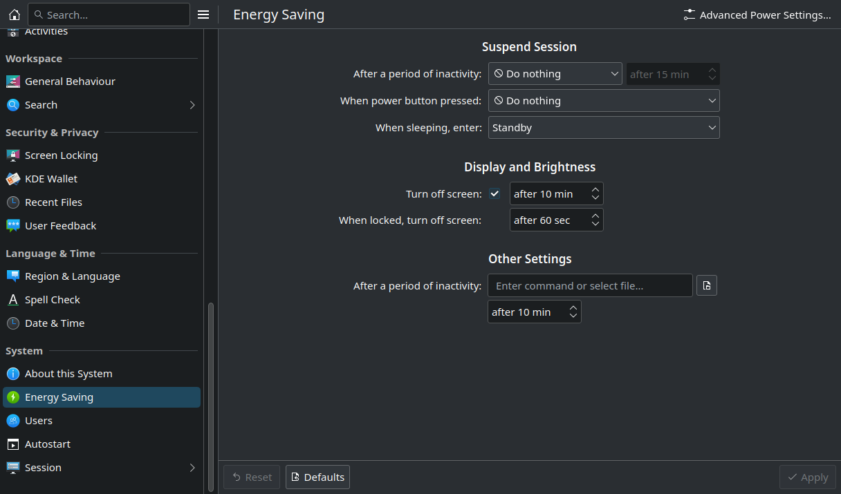

My SystemSettings for Energy Saving are as in the attached screenshot.
If something needs to be changed here, kindly let me know.
