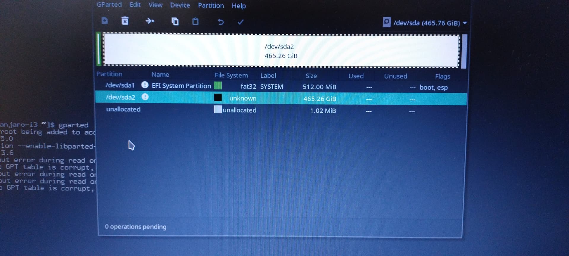

I dont know if this will help.
I mean, it does not hurt to swipe the disk in gparted first and THEN try to reinstall. But I think that is pretty much what the installer is trying to do if you select ā€œerase diskā€.
Just delete ALL partitions and then press save. (all space should be ā€œunallocatedā€)
You have to press the ā€œvā€ (save) for anything to actually happen.
Then try to install by selecting ā€œerase diskā€.
Try that and report back here with the outcome.
If it fails with gparted trying to remove the disk, copy and paste the log text here.
its deleting the partitions, but its giving me ā€œinput/output error during read on dev/sdaā€ error while its deleting it.

GPT table is corrupt
Is likely your problem.
sudo fdisk /dev/sda
Enter g.
Enter w to save.
Note: Data on /dev/sda will obviously be lost.
